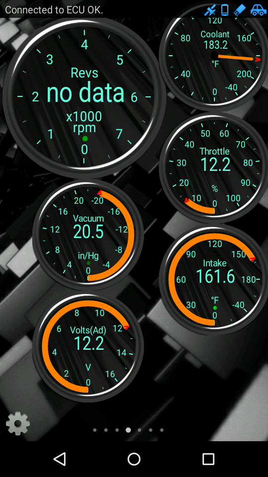

. Hey what does your vacuum show through the torque app?
My plug problem
Engine off
Just a little throttle
