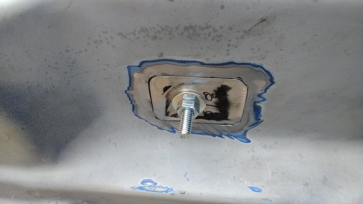

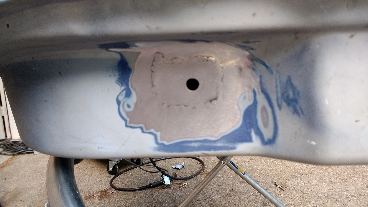

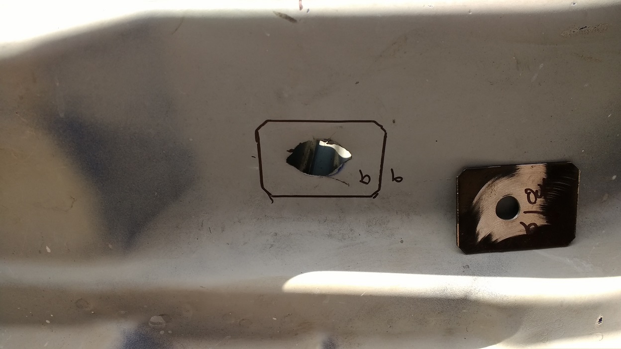

Finally got to the spare door. Was easy to empty it out. Didn't notice the metal fatigue at the lower frame hole. Buy a rust free door, and I'm still welding on it... Had to figure out where the hole was supposed to be, then create a patch. Pic for your amusement.
Attached Thumbnails door swap-regholehosed.jpg   door swap-patch1.jpg   door swap-reghole3.jpg   door swap-regholedone.jpg
