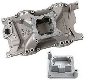

I have no idea if this is actually available, and while it's not the high-rise looking M1 that I returned to Mancini Racing a few years ago, if it's a one piece intake I might seriously consider it!

The one they have pictured isn't EFI for one.... and if you double check the part number it's the 4bbl m1
