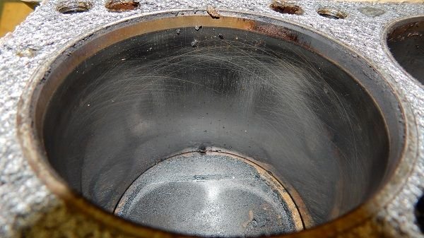

Have the block checked by a machine shop, to see if you need it bored.
X2! This pic is from a motor that had 190K (at least that's what i was told). Cylinders are worn, cross thatch gone. See what the machine shop says, If it's as clean as you say it is you can clean up the cylinder and put new rings in also.
