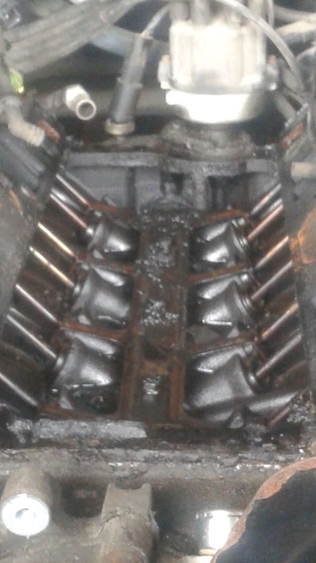

Thanks I removed the two bolts holding the thing above it with the two vacc lines and it came out with a wrench. Just got the intake off and it looks like a freaking sewage plant in here:
Old Mar 28, 2016 | 11:02 AM
Posts: 87,475
Not really unexpected..... shows signs of neglect. Use a shop vac to pick up as much of that crap as you can.
Old Mar 28, 2016 | 11:07 AM
scottw99's Avatar
scottw99
Joined: Mar 2016
Posts: 37
From: Ontario, Canada
Is the bracket and vac house, electronics on the back right fuel rail bolt, and other vac house all part of the EGR?
Is it recommended to remove this or should I leave it all?
Old Mar 28, 2016 | 11:13 AM
Posts: 87,475
Should be a valve of some description on the drivers side of the intake, toward the back. That is the cannister purge solenoid. Not part of EGR system.
Also, your oil pressure sensor looks like it had a bad experience there. Replace that before putting the intake back on. (not to mention cap/rotor/wires, it doesn't get any easier than it is right now.)
