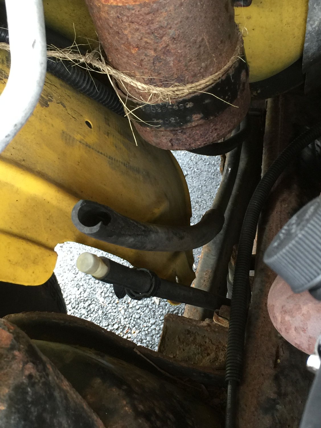

My cannisters are back underneath mounted on frame on passenger side.
It's the fat 90 degree hose on far right that heads up to engine compartment......(btw, please ignore the crud and rust I'm gonna get to that.....)

Should be another back there that goes to the gas tank.

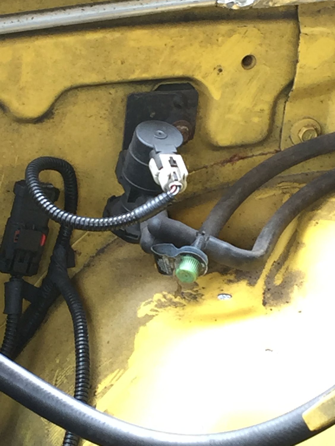

Here's a few pictures of my engine compartment......
This is my truck. See I don't have the leak detection pump.....
And here is the broken hose.....

Not sure about the 99's but my 96 has a vent tube that is on the opposite side(96 had the canister on the drivers side). It should have a vent cap on it, Mine did not and the canister filled with water.
