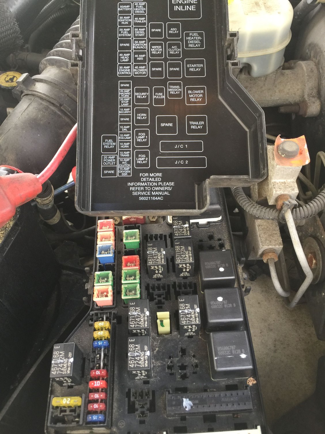

Swap the starter relay with the horn relay, and see if you don't get a little more action from the starter.

-> Ham Bone, none of the bolts have a ground on them. I took it a bit further to see if any of the wires removed for wiper wash tank, due to it being mounted on the left side of radiator could be found loose, unconnected, shorted.
_> Moparite, once driveway dries up from the 20 hours of rain, I'll attempt looking at flywheel, this will be a long endeavor since family is on vacation now and I'm working by self. Gotta tend to wife's flock of fowl. But I'm on leave from work, so I have time.
left sq relays T - B: starter, blower motor, trailer. Horn relay is 2nd from top just left of fuse puller.
-> HeyYou, horn relay is different type so I swapped the trailer relay with starter relay no joy, I also hooked up battery charger at 40 amp to get dash gage to show 14 VDC prior to attempting. Gave all relays a "love tap" too. Currently back on 2 amp trickle.

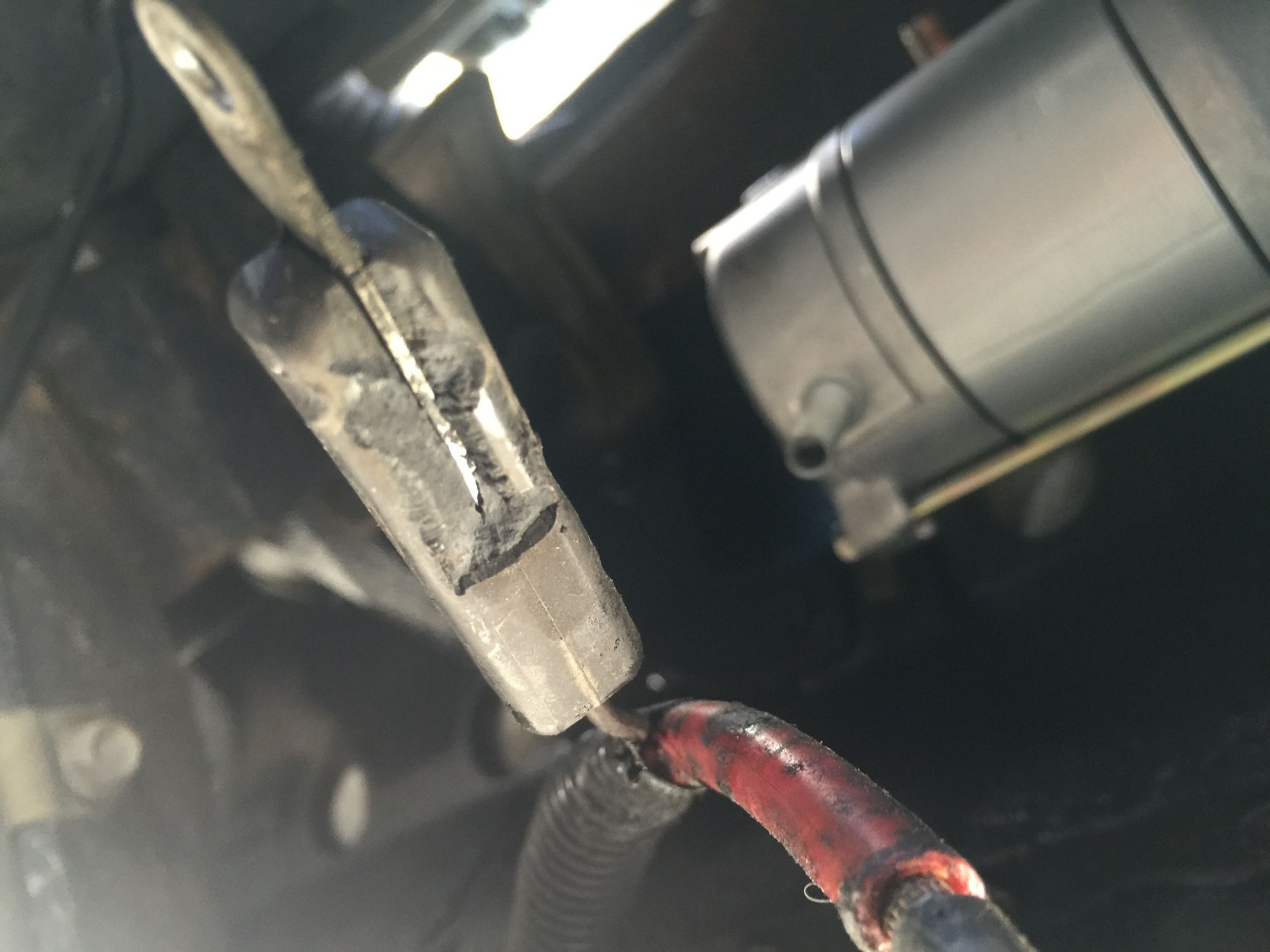

Had logon problems I checked voltage at trigger to Positive battery O VDC to ground. Trigger to Positive Battery terminal 14 VDC. and when I actuated ignition 14.2 VDC.
But when I was checking contact cleanliness the rectangular molding around trigger crumbled.

Image doesn't seem to want to show up.
