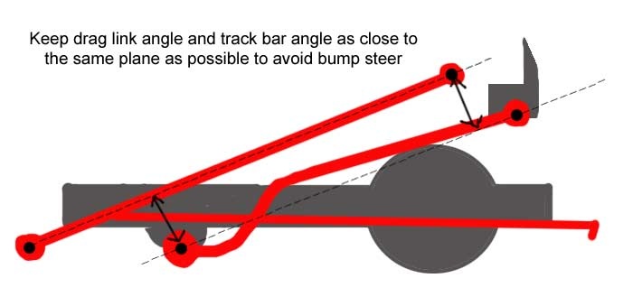

You mean that you left a 2" spacer in there, with the 2500 springs? Your track bar should be at the same angle as (parallel to) your drag link off of your pitman arm. It's probably not. You now have about 4" of lift, you might want to look at a drop bracket for your track bar or an adjustable one. Others may chime in here also, but you also should take a look and see if you need a drop pitman arm too.

Here is a pic...

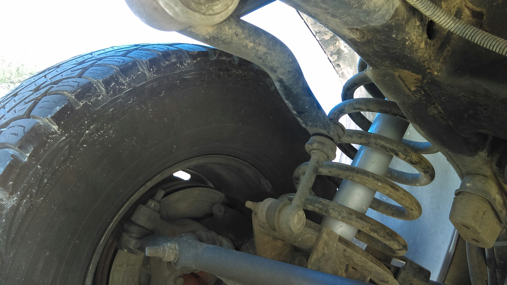

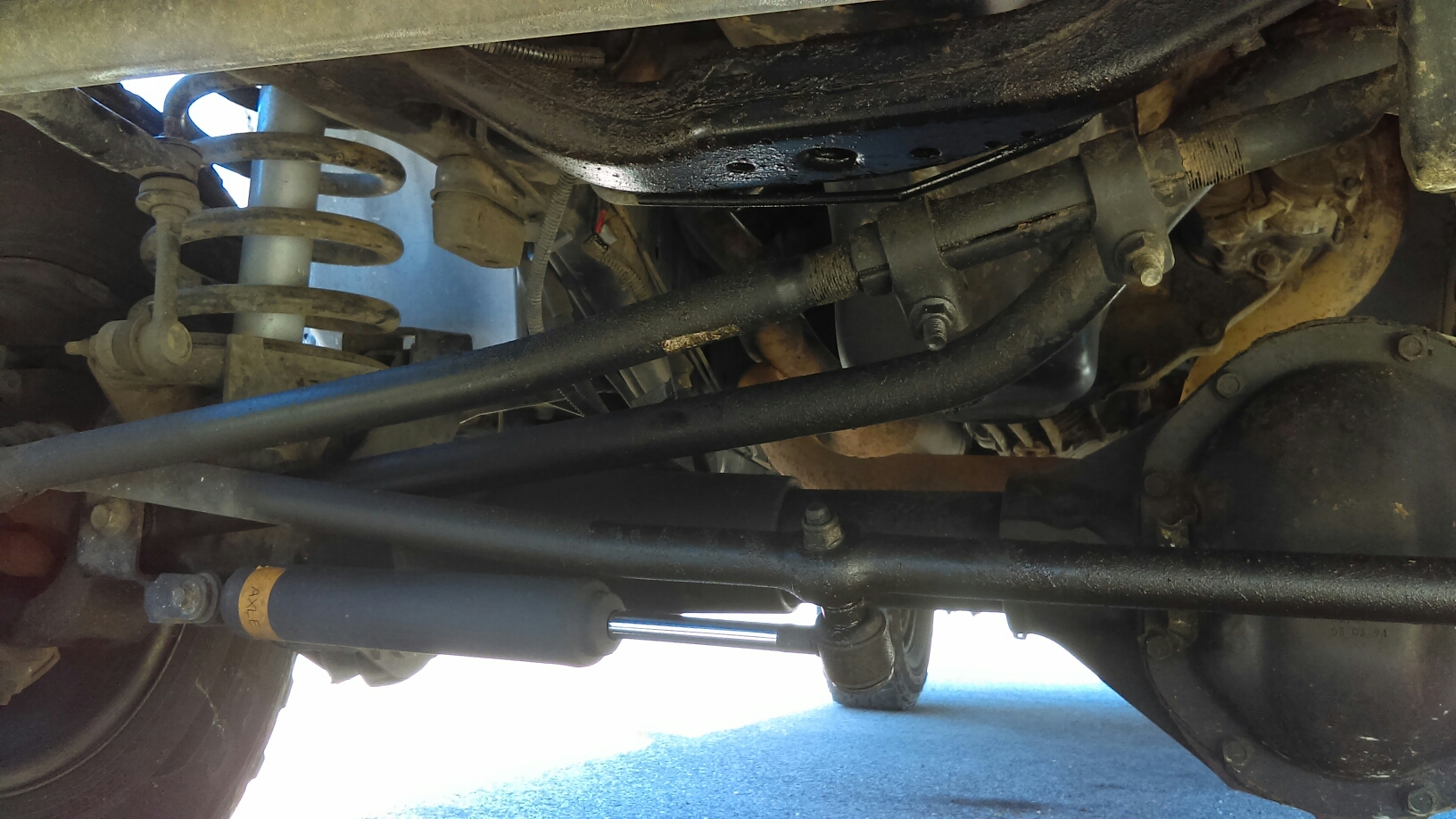

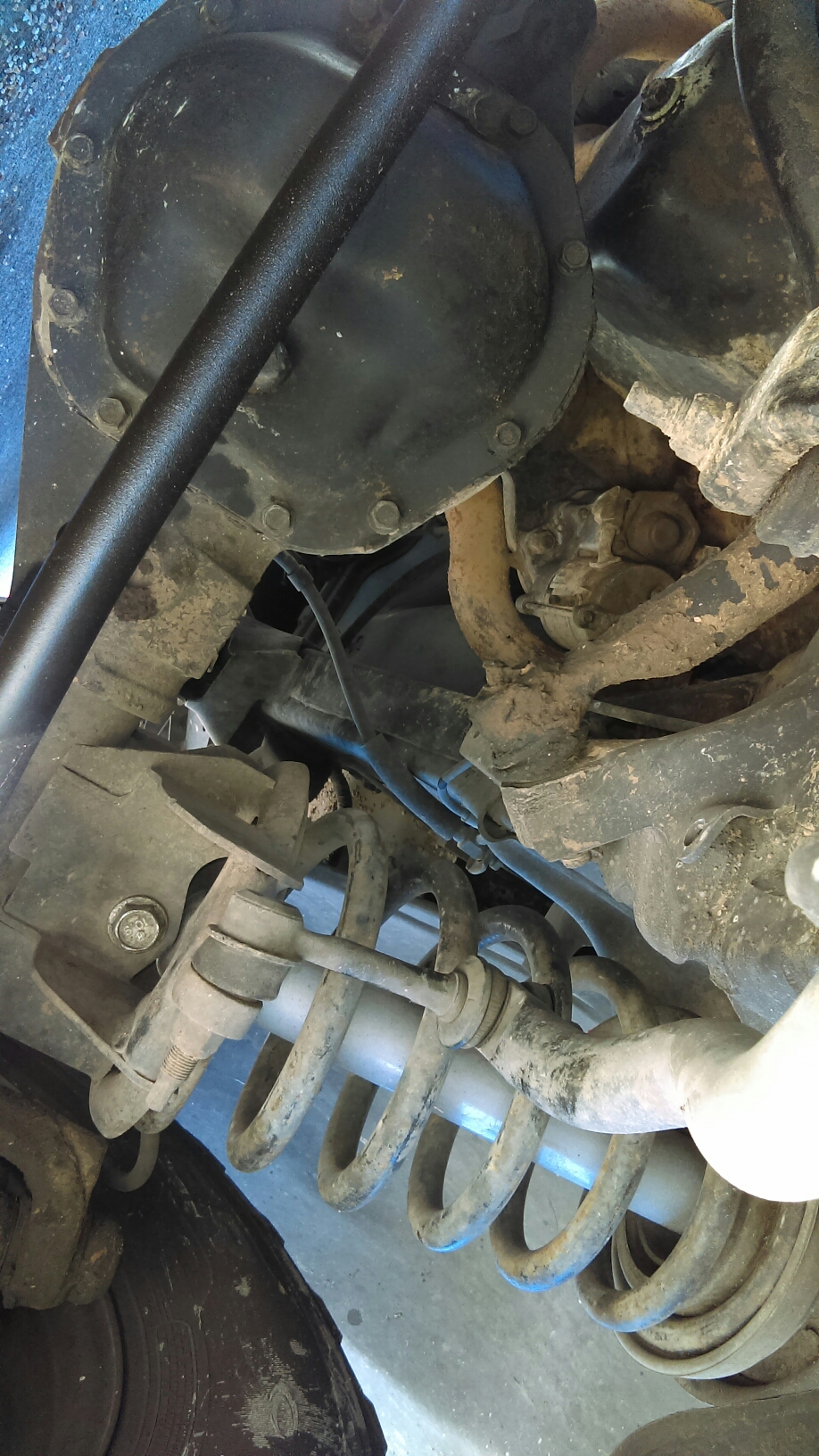

I got a chance to get up under my front suspension to look at it today in the daylight and the sway bar links or the track bar arent at bad angles so I think I got ****ty 3/4 ton springs....
