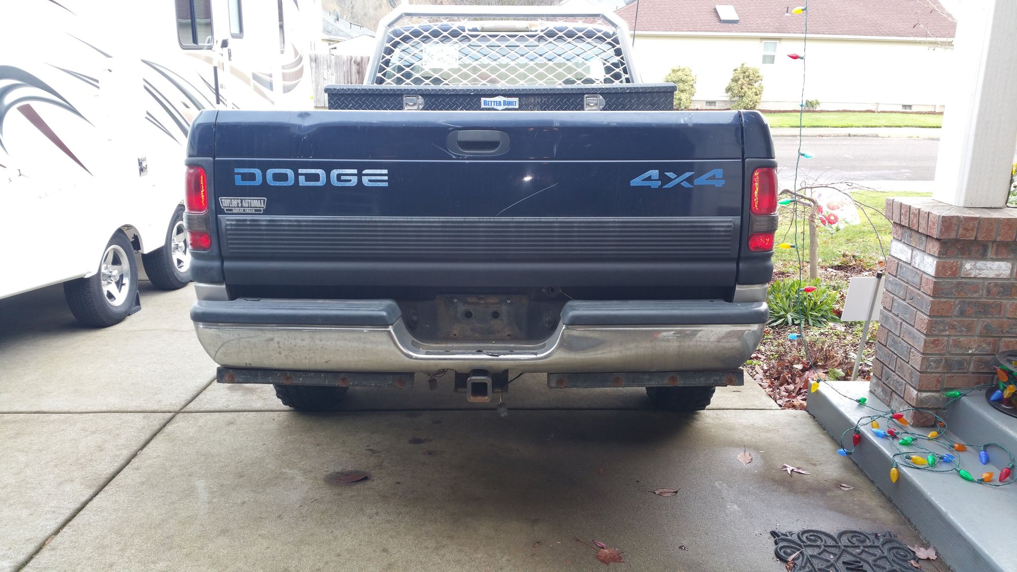

Any help is greatly appreciated I attached a couple pics, the body is pretty rough and the paint is pealing of course.

Well, it looks to be in pretty good condition at least. But, it IS a HIGH mileage truck, so, some repairs are to be expected.......

The truck really doesn't look that bad..... might be worth sourcing an engine from a more *reliable* place... wrecking yard, or whathaveyou, that you can actually see the vehicle it came out of, and have some idea of how many miles are on it.
