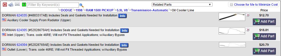

Would any of these be the one without the check valve?
Attached Thumbnails transmission check valve delete line-trans-cooler-line.jpg
Old May 3, 2016 | 10:42 AM
Posts: 87,483
maybe. Check the description, see what it says.
Of course, getting one locally, means you can take it out of the box, and physically inspect it.....
Old May 3, 2016 | 10:48 AM
dbbd1's Avatar
dbbd1
Joined: Sep 2015
Posts: 1,552
That's the whole line. First link was just for the flexy part.
I know but that's what I ordered and received, without the check valve.
The flex line above "looks" like the coupling end "may" be big enough to still have the check valve in it.
The descriptions do not give you a clue but the newer trucks had the check valve removed from the system, so the replacements no longer have it either. Just not sure snout the flex line alone, as shown.
