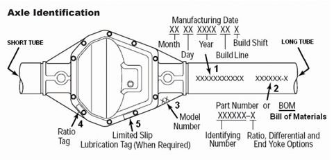

Thanks guys should have no problem with the nut now but this morning to gain access to our lawn mower I had to back the truck up 2 feet and the inner axel shaft broke at the ring :/ so with it being a dana 44 could I just go rip one off any other dana 44 dodge ram?
Old May 6, 2016 | 03:52 PM
Posts: 87,549
Likes: 4,230
Probably. Take the old one with you though, and compare sizes, and spline counts.
Old May 6, 2016 | 09:29 PM
Moparite's Avatar
Moparite
Joined: Feb 2015
Posts: 7,435
Likes: 578
It may help to get the info off the axle and compare it with the one in the yard. Not sure if they changed and when.
