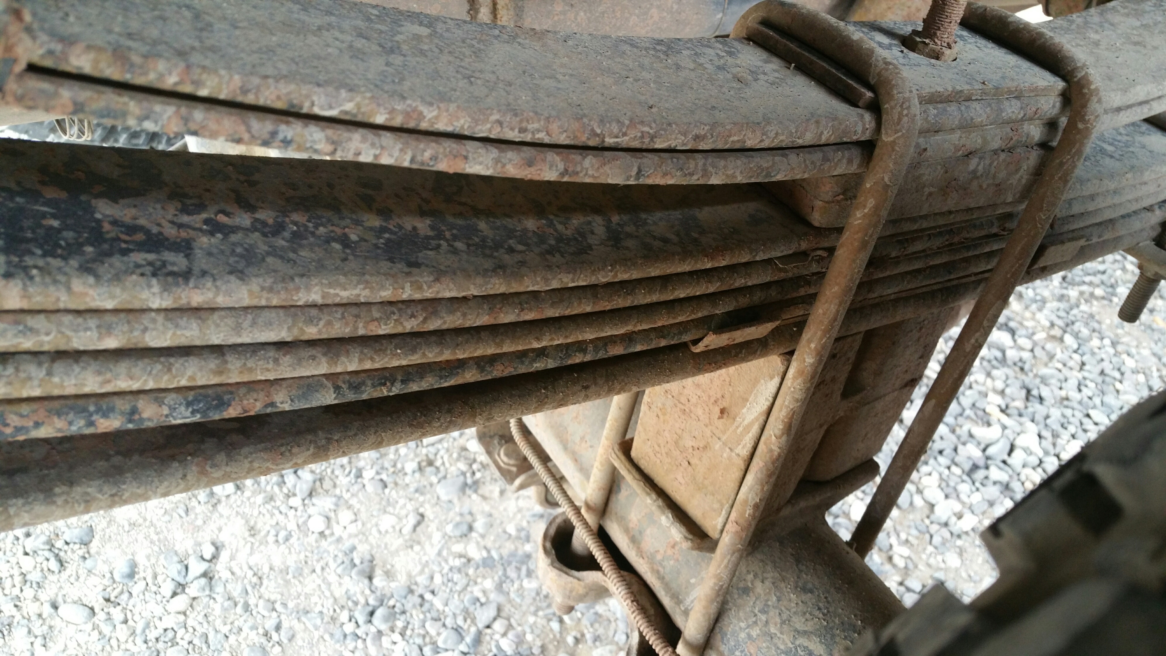

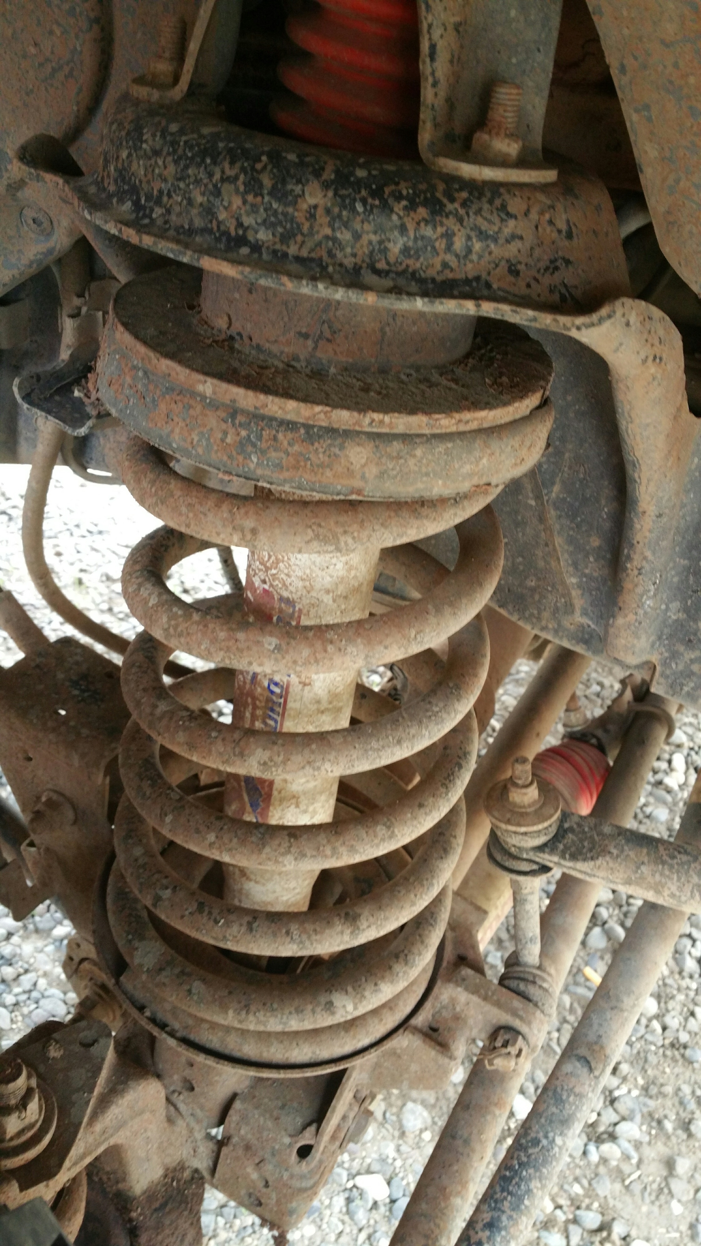

here are a few pics of my rear suspension and 1 of the front. sorry they are not very clear its hard to get a picture behind a 37" tire.

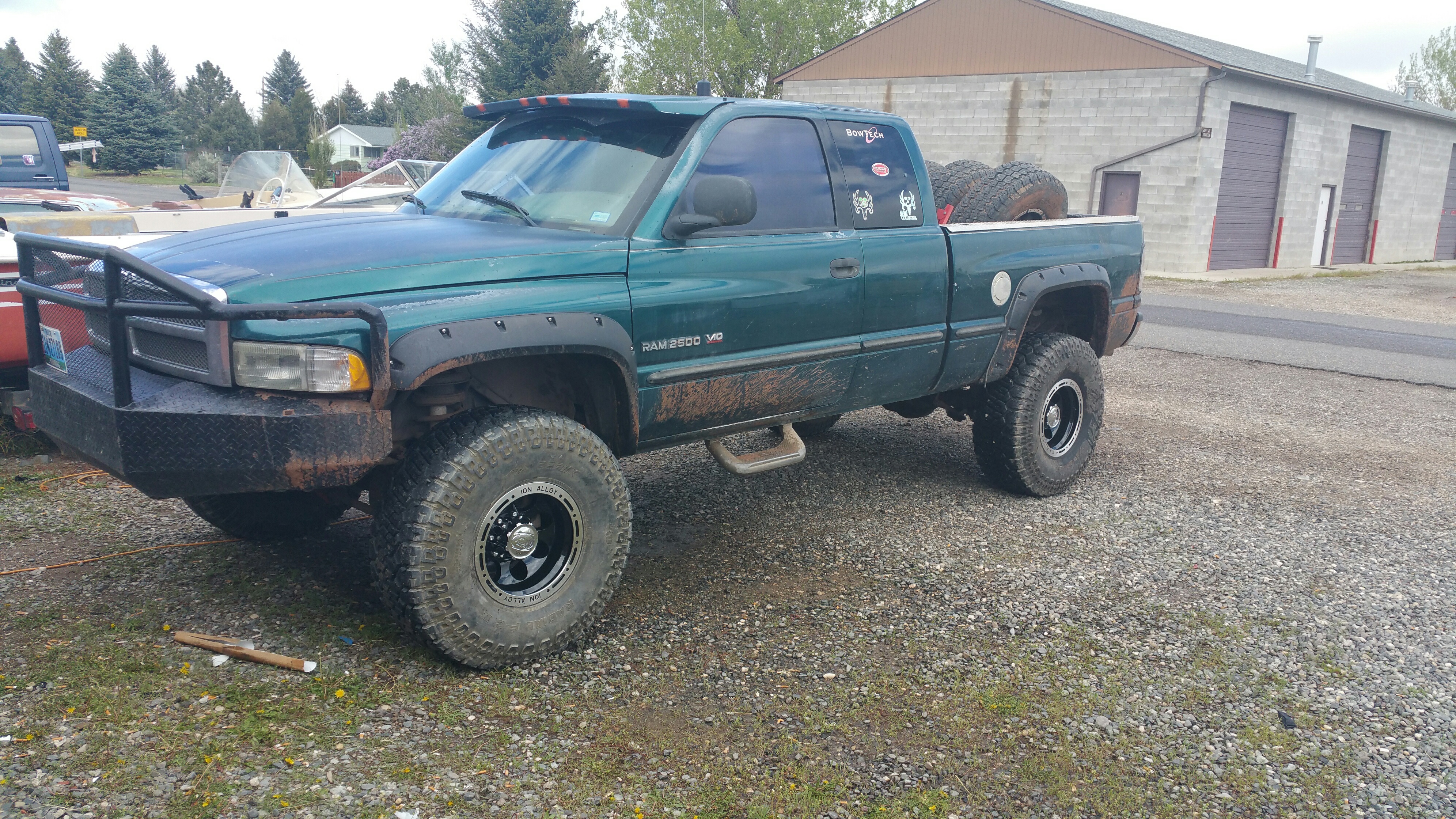

also a picture of the truck itself.

i really need to know if they are stock springs because i have a guy local that has 2" springs and if these are stock i will get them to add when i do all the work on the front end

I might not know if this is makes much sense, but who's to know how much a stock spring may have sagged? maybe that's why there are spacers installed

i just went out and measured it is 45" to the ground from the fender lip. so when you figure 3.5 inches is from the tires compared to race fans truck then its only 1.5 inches higher. probably from the 2.5 spacer and then the added weight of the bumper. looks like i am going to add 2" springs when i am tearing in to the front end. makes me glad i got the adjustable track bar.
