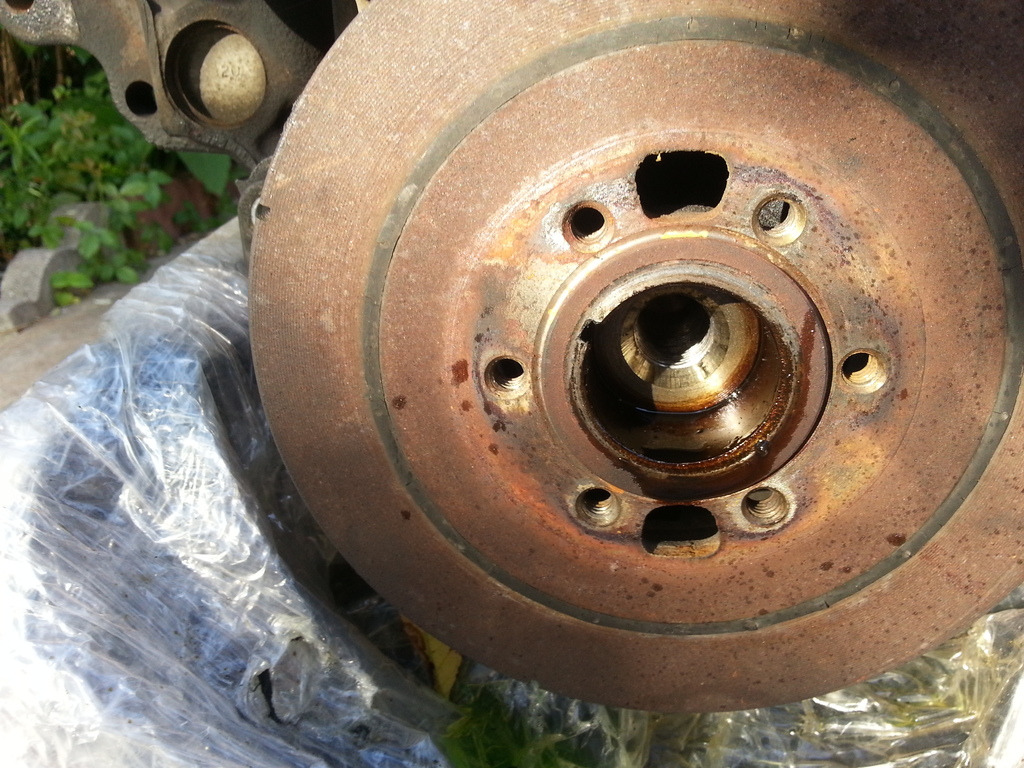

Old Jun 17, 2016 | 09:11 AM
renardk764's Avatar
renardk764
Joined: Jul 2012
Posts: 387
From: Austin, Texas
This answers the question. Just pulled the balancer bolt of an untouched 5.2. The crankshaft does not go to the edge of the balancer.
