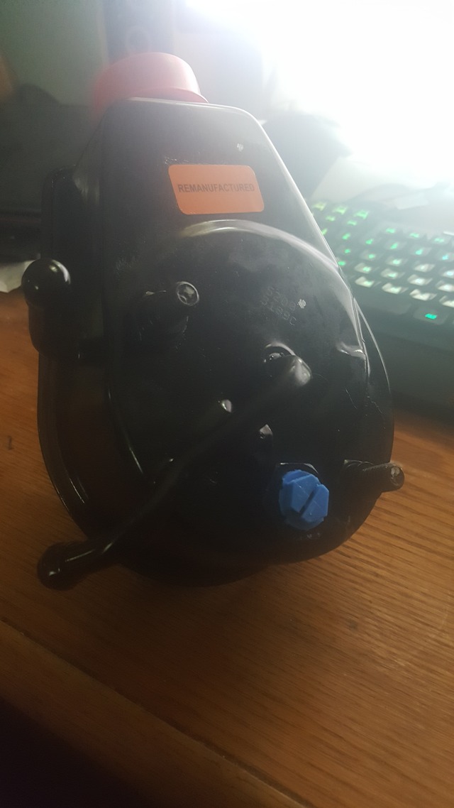

I bought a power steering pump for my 2000 Dodge Ram 2500 but it has an additional line coming out of the side. Can I just block this off? And what do I use? Name:  20160609_114809_zpspwutwlpc.jpg

Its probably return line from brakes hydro boost on the diesel trucks.
Cap it off and all good
This. Exactly.

Big Thanks !
