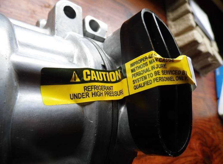

It is preloaded with 6.4 ozs of PAG46 oil, but has a warning label on it that it contains refrigerant under pressure, and is sealed with a plastic plug over the line connections, held in place by a metal nut.
Question is, how can I safely undo that nut and release the pressure without spraying PAG oil everywhere and losing some of it..?
I'm thinking of covering nut and plug with a cloth and undoing the nut slowly and gently, gradually releasing the pressure...

There shouldn't be any refrigerant in the new compressor....... But, just in case, crack the nut slowly, and see what happens.

Default Warning Label Over Securing Nut...
Here's a pic of the warning label covering the nut securing the plastic plug... definitely says refrigerant under high pressure
Old Jun 24, 2016 | 09:10 AM
Posts: 87,415
Likes: 4,214
That makes zero sense..... You HAVE to open it up to install it..... unless it works by wishful thinking...... I guess you don't get a choice, just be REAL careful when you crack it open... Go VERY slowly, and let the pressure bleed off.

I think that is referring to the refrigerant in the system. ??? An idiot warning. What does the paperwork that came with the compressor say?
