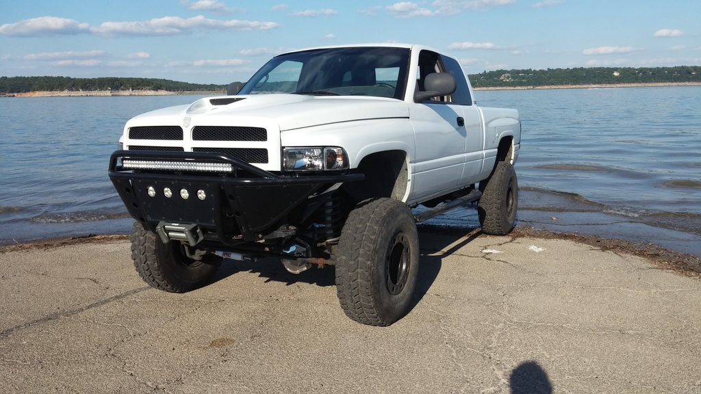

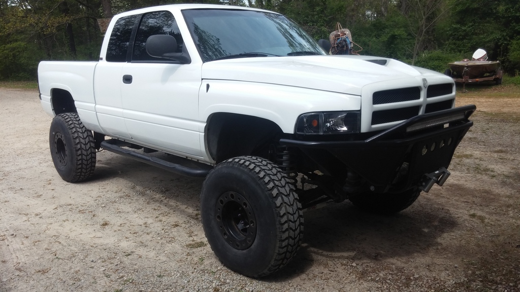

I think that could be achieved.. here are a couple pics of what it looks like currently

Old Jul 8, 2016 | 12:08 PM
Posts: 87,554
Likes: 4,230
Ok, I can see why you would want to keep that truck......
Old Jul 8, 2016 | 12:09 PM
Flippinrigs's Avatar
Flippinrigs
Joined: Mar 2016
Posts: 13
Yeah, I already get a lot of thumbs up going down the road of our little Arkansas town
