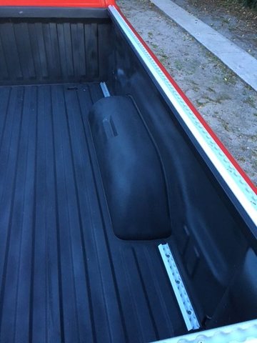

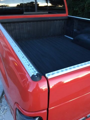

The factory tie down points in the back are on the pillars next to the tailgate.
The front are in the floor of the bed.
When I bought my truck, I got MOPAR stake pocket tie downs (popup hooks).
After a recent repaint, I added bed rail tie downs... these I love... you can put a ring anywhere you want.

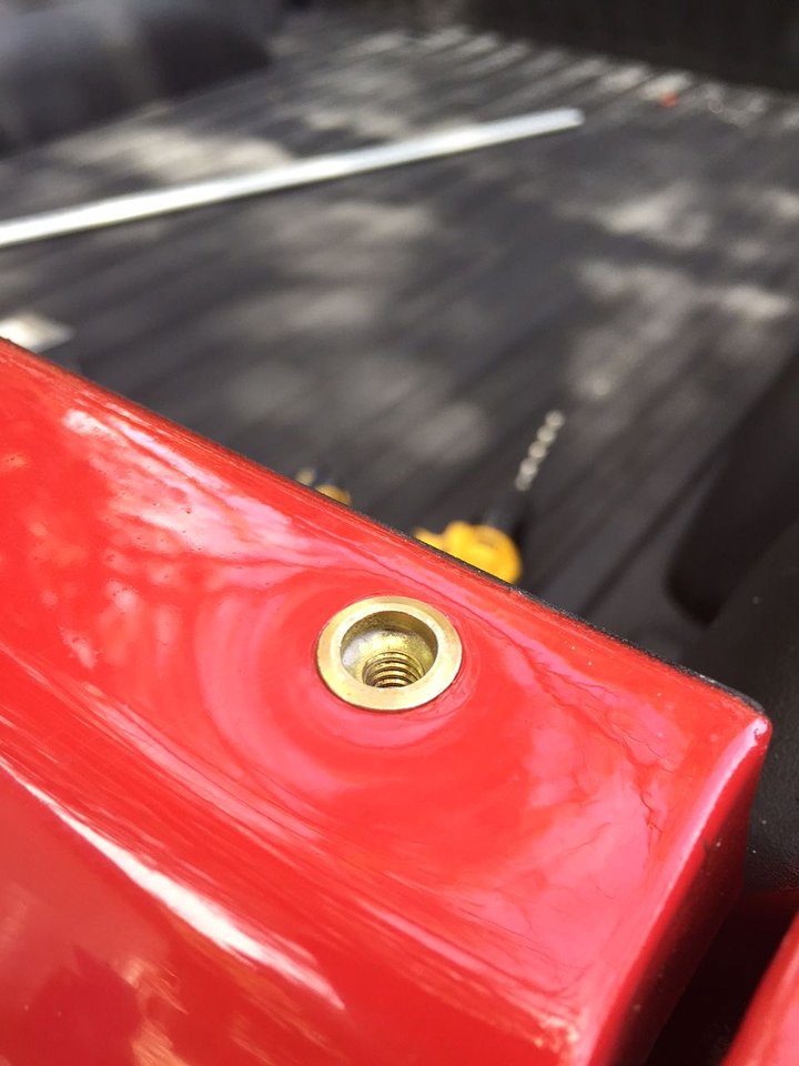

For my spider net, yes... you can hook over the front rail of the bed also.
I never hooked a ratchet tie down directly to the rail... guess I thought it a bit weak for securing a load of any size.
However, after installing rivnuts through it, I now know it is double layer with about an 1/8" of bonding agent between the layers.

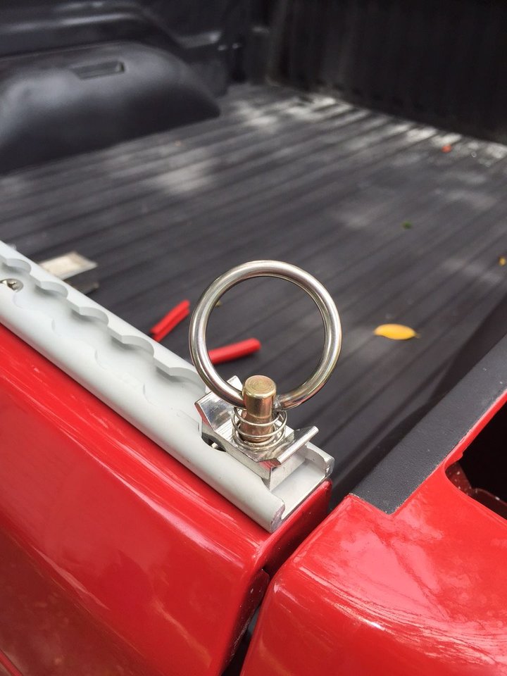

From: S. Florida
I've got rails on both sides and across the tailgate, plus a strip in front and behind the wheel arch.
You can position rings in 1" increments.
The rails are bolted down every 4".
