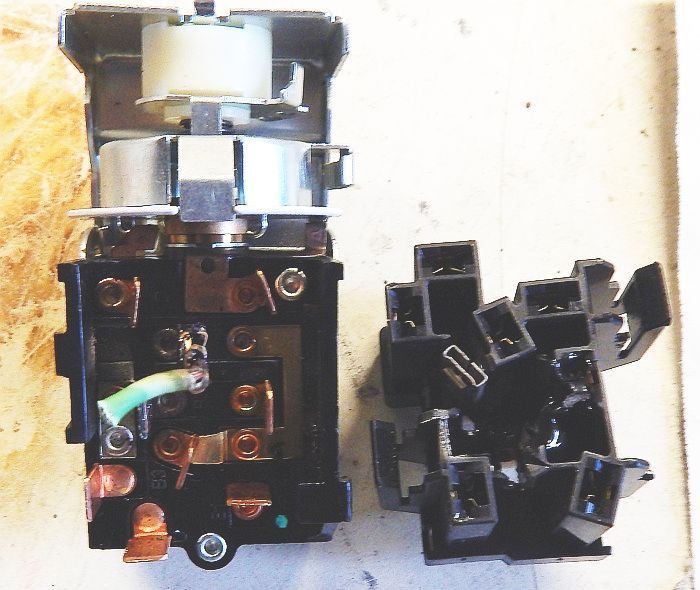

You replaced the headlight switch but what about the connector? The 2500's and 3500's have more lights to run than a 1500. This subject was talked about in another thread. There was a update for the issue with the 3500's but they seemed to forget about the 2500's. This is what mine(2500) looked like.

I replaced that as well. Would the positive battery cable having some corrosion on it have anything to do with it?
