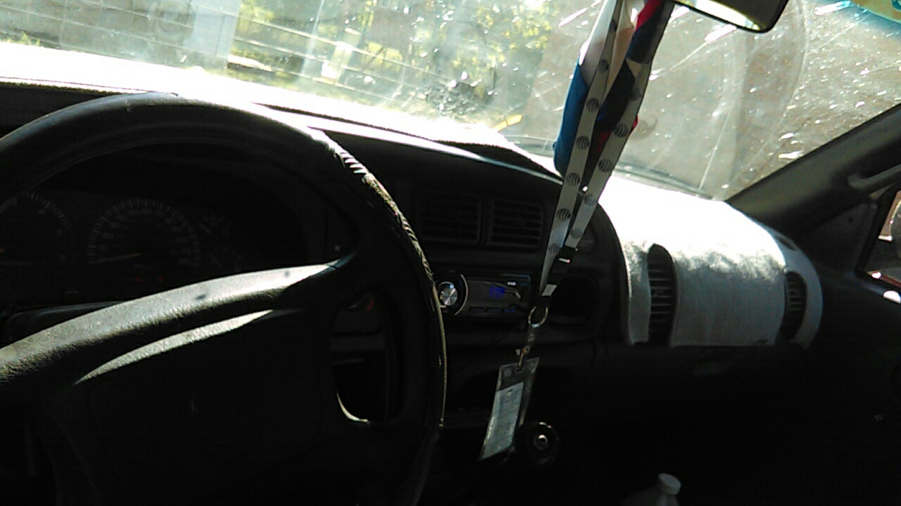

I have play in my steering wheel. Have already replaced Pitman arm and steering gear box and had an alignment done. It feels like there's a bushing or a part somewhere in the steering under the hood that is worn out or messed up. Any insight would be great.

Have someone else wiggle the steering wheel, while you look around.
What brand steering box did you get? If it is just some generic, stock replacement box, chances are good that is where your slop is.
