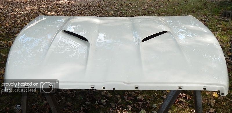

I think people are getting confused about CAI's. The major difference is the filter element! Below is a video of real dyno testing with different filters only. Stock set up not what some of the so called "cold air" intakes do witch is use the hot air in the engine compartment. So if you think all the hype is about the CIA system it is not. What are some of the small differences that can effect performance is the accordion style air inlet on the stock set up. It can cause turbulence in the incoming air but only during high rpm's. The smooth ones on the CAI's will improve things somewhat but mainly at high rpm driving not every day driving. And it's not going to be in the double digits gains. If you want bang for your buck replace the stock filter with a K&N (like i have in mine ). If you want a true cold air/ram air intake get one of these...
It's a functional ram air hood!
