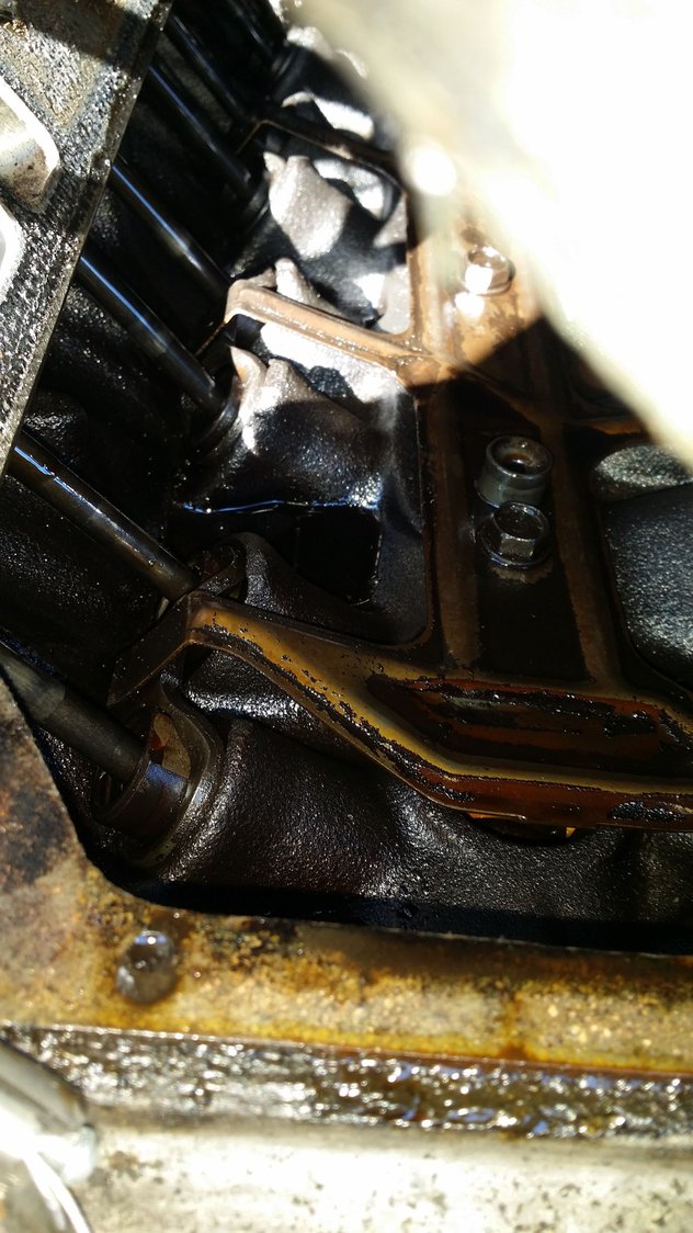

Old Sep 26, 2016 | 11:47 AM
dodgeindy96's Avatar
dodgeindy96
Joined: Sep 2016
Posts: 19
Old Sep 26, 2016 | 12:20 PM
Posts: 87,482
Did the lifter blow apart?
Old Sep 26, 2016 | 12:34 PM
dodgeindy96
Joined: Sep 2016
Posts: 19
I'm not sure yet. Have too get the fuel line removal tool too fully take off the manifold.
