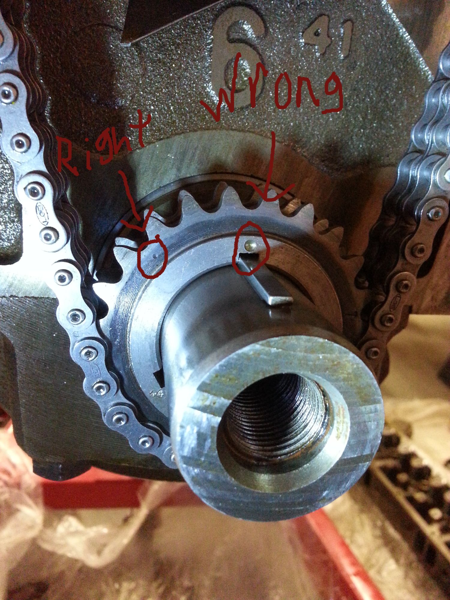

Nice collection of parts! Careful with the MOPAR Double Roller, I've got the same chain, and the crankshaft sprocket has 2 dots on it, one big and one tiny tiny dot. You need to align with the tiny dot...

Thanks for the replies, I completely forgot to give the truck specifics. Its a 2001 Ram 1500 4WD Off Road Edition 4.10 gears 33" tires. Thanks for the tip on the timing gears. I didnt even look at them yet but im sure I would have had to ask about that. Bastards! Thanks for the PICs. It sucks that I have the rocker arms already, they are brand new in the box yet, but plans change. I figured if I got a cam I wouldn't be using them. I just cant have the engine this torn down and not go the extra step. I just dont want to throw parts at it Im trying to make it all work together. I was leaning towards the 192 heads, I dont think Im going to be able to make full use of the 2.02 since Im not really looking to rev to high. Is odessa or clearwater the same as Hughes? I get skeptical of ebay stuff. Out of the two cams you think the comp would work best? I know that the MPI 2BBL and better head that can flow along with LT headers will push me a bit up in RPM range for torque, I would like to balance that with a cam if possible. So Im down to the two listed above and this one I came across. Browsing the forums seems like people like it alot.
