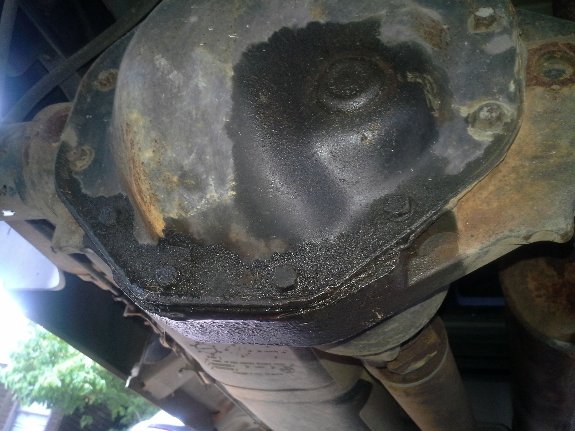

Hello. I was hoping I could get help identifying which rear end piece the truck has on it.
At the rear of the truck theres that round cover for the differential. It holds the gear oil in it, I believe. I think that oil might be called 75/140?
Well, theres a leak right there, at the bottom of the cover. Its sort of reddish/black color. But it drips out, pretty slowly, but drips a little, everyday! So I think it could be low at this point, and maybe low enough to ruin it causing replacement if I keep driving the truck.
I did find the sticky that shows me how to replace the oil that goes in it, but he says it's the 9.50 sized one, or something like that and that its NOT the dana?
Do I have to do anything different if this truck has a diff size one? And much less important, can I get a shiny new chrome one or would that look stupid!
Any feedback helps me probably more than most. I've never had a 4x4, or a truck like this so I don't know much yet, not many of the basics, like all of y'all do.
After the help y'all shot me pertaining to that transmission's shaft seal replacement, I know this is probably too easy for you guys/gals, so I thought I'd start here before even loosening 1 bolt off of that cover!
Thanks!

You have the chrysler 9.25 rear. There are all sorts of accessories available for it, including chrome covers. Things like that are just a matter of taste. If you like it, have the money, then go for it. I personally prefer function over form, so, mine are still the original steel fellers.
All you really need is fluid, a tube of RTV (red, or black), and a bit of time. It's an easy job, takes less than an hour. (couple cans of brake clean to spray out the old crap wouldn't hurt either.....)

Looks like your is leaking mostly from the fill plug. Take it out, and clean it up good while you have the cover off.
Basically, the fluid is just gear lube. 80w90 for most usage. 75W140 (synthetic) if you do a lot of towing. I don't think brand really matters. I just grab whatever they have on the shelf at the parts store. Don't worry about a gasket for the cover either. Just be generous with the RTV.
I think it holds in the neighborhood of two quarts..... so, having three might not be a bad idea. Take off the cover, let the fluid drain (having a good pan under it is a good idea....) spray it out with the brake cleaner, let it dry out for a few, put a nice bead of RTV around it, and bolt the cover back on. Let the RTV cure for maybe half an hour, then fill the rear end up to the bottom of the fill hole. Let it sit for 10 or 15 minutes, and check the level again. Top it off, put the plug back in, and you are pretty much done. Check level again in a day or two, just to make sure.
