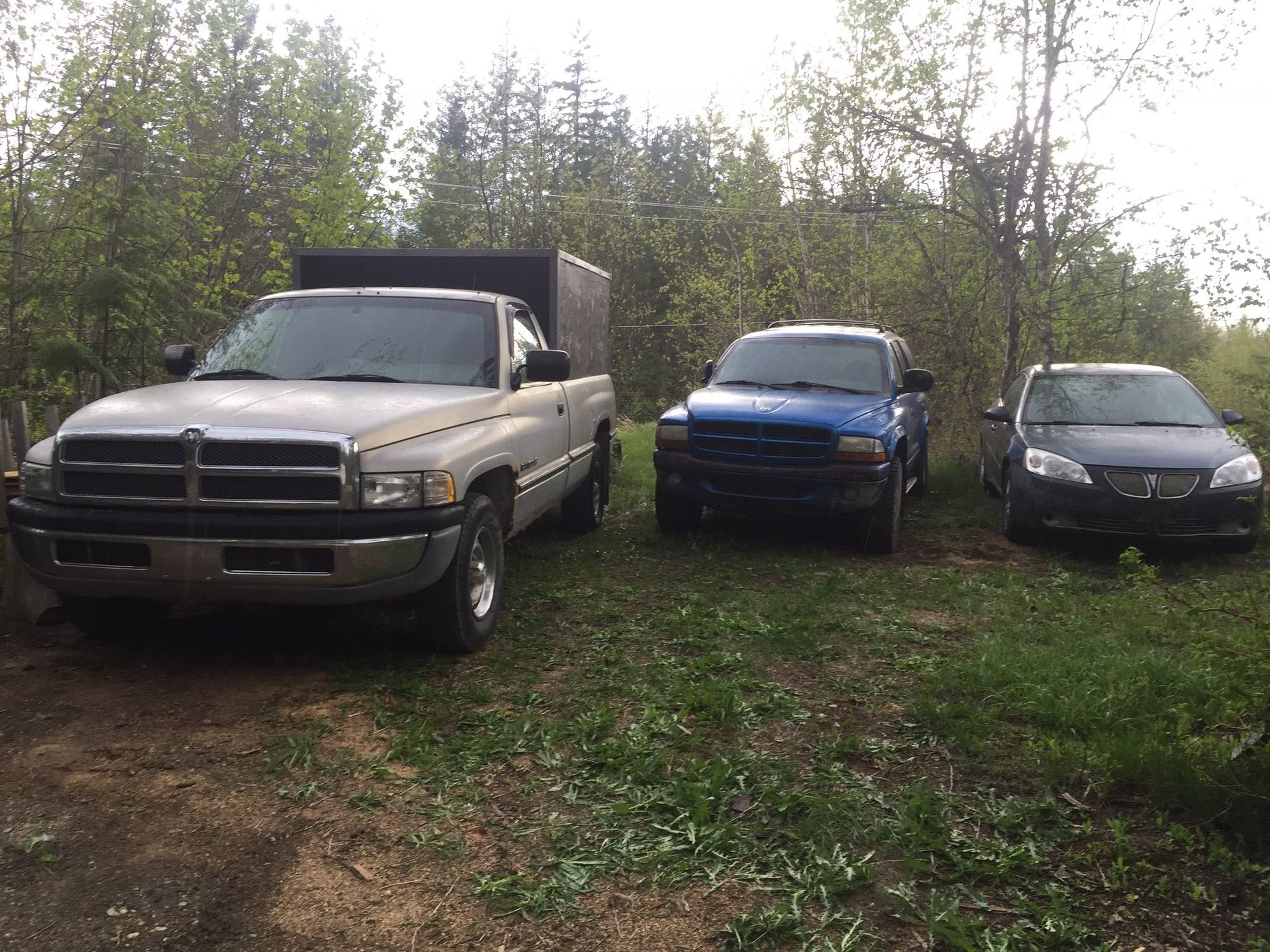

Thank you for all the great info! I am currently about to start an engine swap from a 99 Durango to a 95 Ram 1500. It'll be a big job due to the fact that I'm also wanting to swap transmissions, transfer cases and differentials. (I need a different drive shaft.) But I really appreciate this info!!
Do you have anything else you'd suggest?

Hey! Thanks for that info! I'm not trying to make it sound like a bigger job than I have too, but I've been thinking that I will need to swap the computers and all sensors/wiring harnesses between the two. I've been experiencing some pretty wild issues prior to committing to the swap, and from what everyone has told me it sounds like my computer is shot to ****. Could you tell me, would I be looking at some intense work with swapping the computers and wiring? I have experience with remote starters, sound systems, replacing fuse boxes, but I've never had to screw around with a computer... (Let alone ever touched much of the wiring associated with it.) I'm hoping I can just swap the harness and computer with as little modification as possible.
