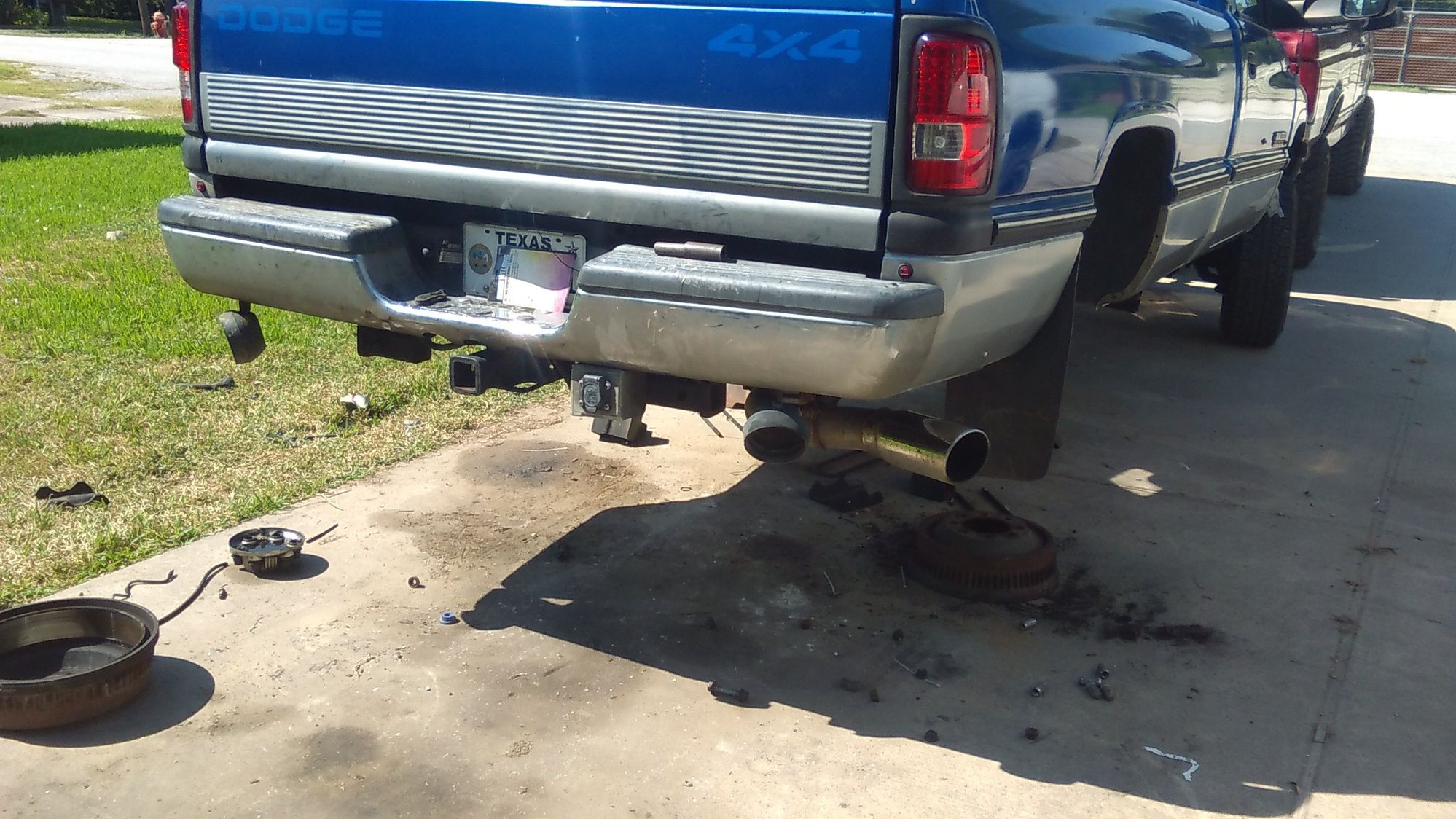

Pretty explanatory. After reading about the Dana 70u and all of its pinion issues, I've decided to swap it out. That, and replacing the bearings every three months has tried my patience to the end.
So with that, I've done the best research I can before attempting this, but wasn't able to find anything.
Axle yanked. It took a 21mm impact on the u-bolts. 8mm wrench to take the yoke bolts off. 3/8 brake line wrench to remove the rubber hose coming from the frame. 13/16 wrench and socket to remove the shocks. Some fidgeting with the parking brake too.

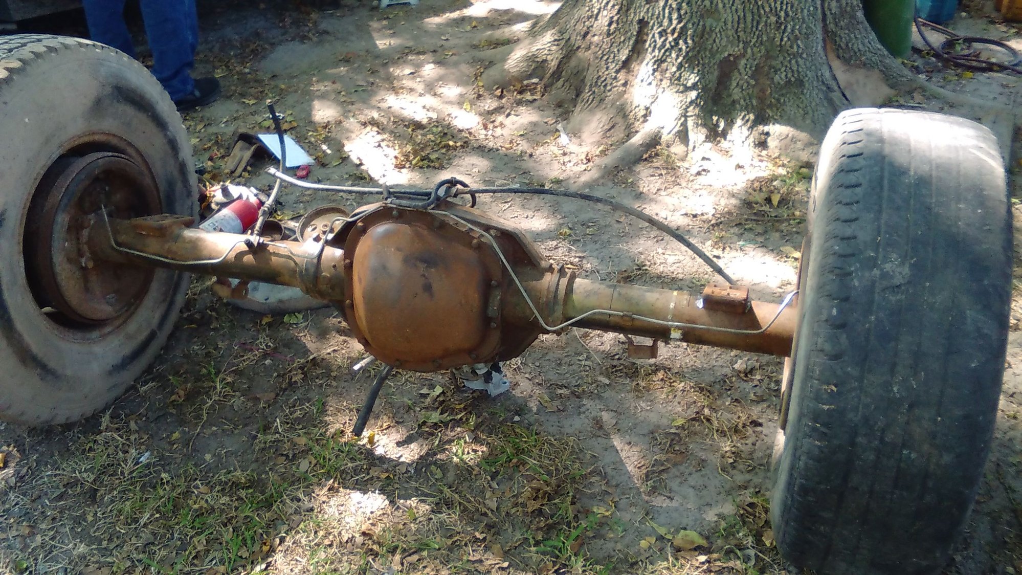

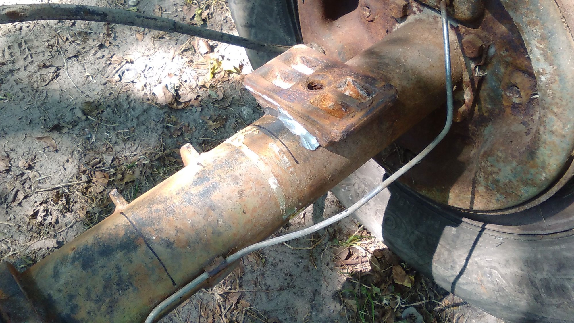

Got the Sterling from a friend. It rolls and has limited slip from what it feels like.

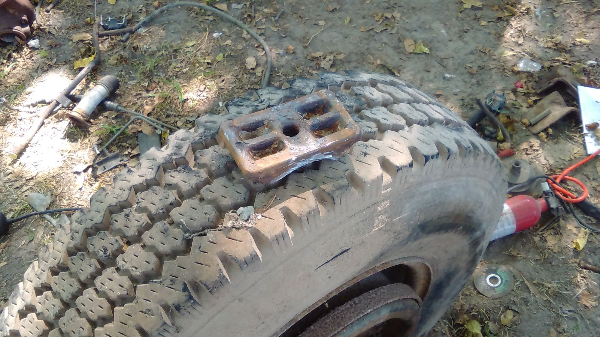

Now to finish grinding off the shock mounts.

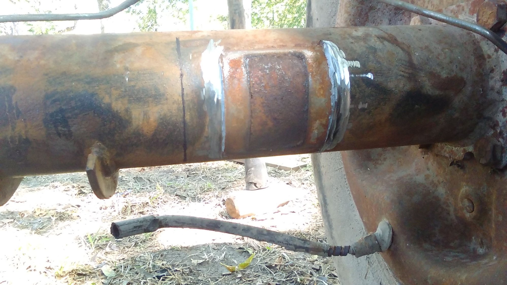

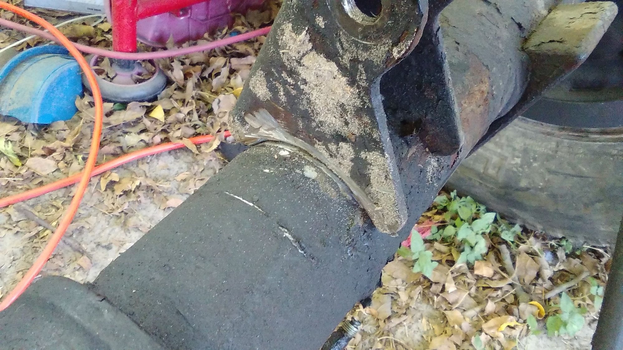

Finally done.
Mock up for later.
Time to grind the Sterling now.

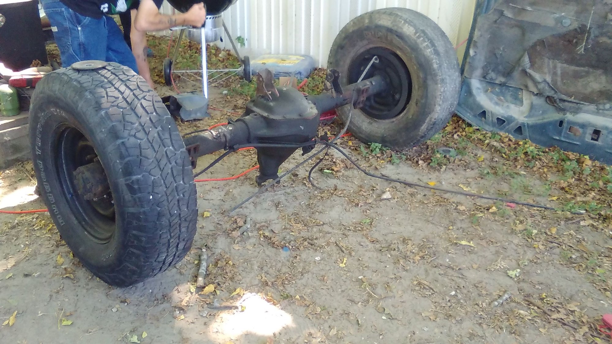

Old Oct 8, 2016 | 05:50 PM
Bushwookie's Avatar
Bushwookie
Joined: Mar 2016
Posts: 22

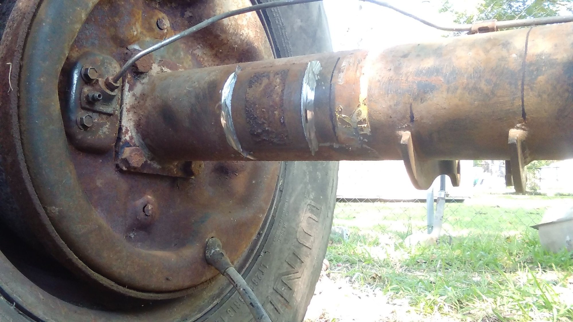

Driver side perch
Passenger side

Now for the hard part. Gonna need to get the correct pinion angle and proper spring width.
