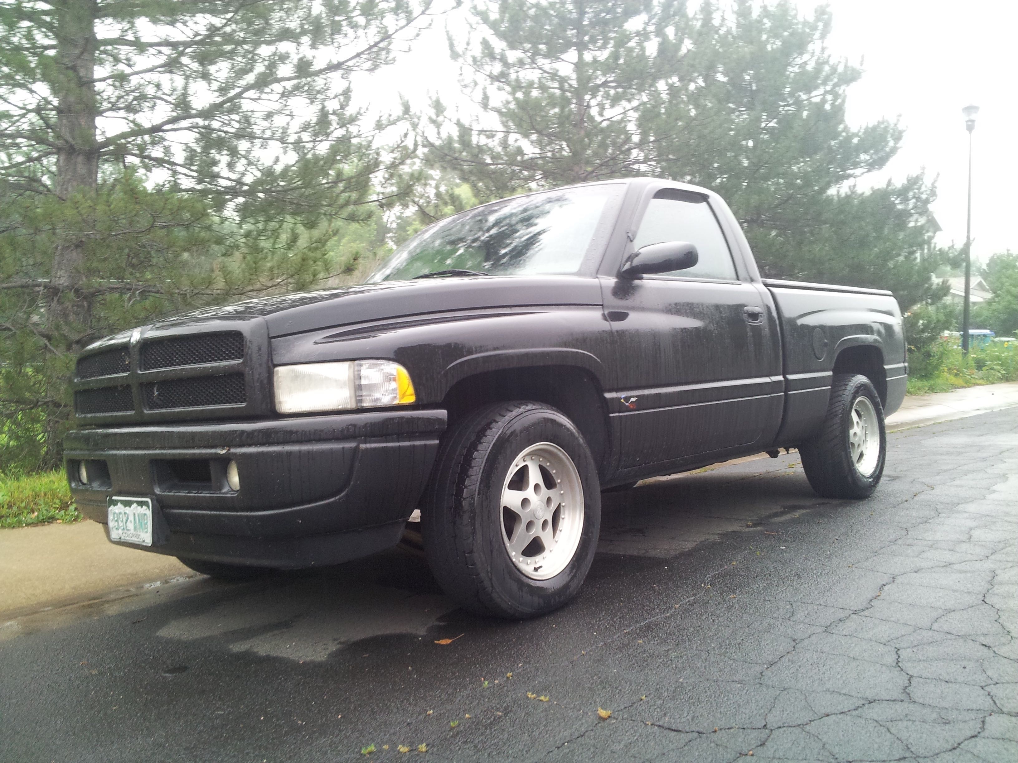

1996 Indy Ram purchased 12-31-1999
5.9 with 162000
This is only my second 360, the first was a brief (until I could find a big-block) replacement for my blown 340 in my '72 roadrunner back in 1980. Apparently, this engine was released in 1971. I cannot help but wonder why this engine is so much more trustworthy than the engines that I had the seventies. Maybe it is not the engines that were so bad as were most everything attached to them. The only thing that I have replaced is the water pump at 148000 miles.
I do, however, have a number of minor issues...
1. On day seven on a recent trip to the Colorado mountains, the oil pressure gauge started flexing from just over the middle line to below zero. I tried to find a pattern but could not. I did notice that it would occasionally rise after coasting.
2. No air flow from the vents under heavy acceleration such as going up a hill.
3. A shimmy while braking for the last year or so. This happened back in 2000 with 89000 miles. I must have been feeling lazy as I took it into a brake shop thinking that the rotors would need to be turned and they called saying that they would need to be replaced. There is very little pad left and I see no serious scratches on the rotors. Is it common for these rotors to warp? I plan on pulling the wheels this weekend.
4. The cruise control button sometimes needs to be pressed a few times for it to turn on.
5. The drivers side window control button needed to be pushed a few times last Friday before the window rose. Sunday morning, I drove the last five hours with the window down as it refused to go up. When I returned home that afternoon, in order to remove the door panel, I disconnected and reconnected the harness from the switch…it then worked…another bad switch? I last replaced the it back in 2010 with 134000 miles.

Is that an SS/T or painted black Indy? I like the road runner on the front of the door! The magnum engines are recreated LA engines. The same for the most part but with a few improvements. Your wild vents and cruise issues are probably issues with the check valves. At some point there was a tsb that added one check valve. If you don't have two get two new ones and install them like in the diagram. The first check valve is after the elbow in the passenger side of the intake.

I have no room for vehicles in my garage/shop so the truck was forced to sit in the hot Colorado sun which resulted in most of the paint peeling from around the stripes of the hood and cab. There was no reason to spend the money restoring the paint just to have it happen again so I had it painted in a tent in someones driveway with John Deere blitz black which I assume can handle the sun as it is formulated for industrial applications. The jambs, engine compartment and bed are still blue. Maybe someday it can be restored to its original condition and it will hopefully look half as nice as yours! I thought it would be fun to remove all decals and apply the roadrunners stickers...beep-beep!
