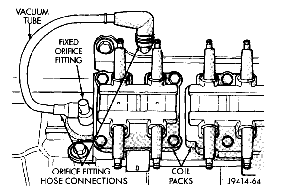

Sorry, no PCV on this engine. It has a fixed orifice fitting, maybe unique to the V10?

Still, I would check the hoses on both sides of the system for evidence of oil. Plastic degrades over time, gets brittle, and perhaps pieces break off.......

Even though it's not a pcv, both of those fittings have specific flow rates and even a little sludge or debris can affect that. Download the parts manual from the faq section to get the part numbers. Both are readily available all over the place. I got my replacements on ebay. Also double check the hoses to those fitting for leaks or restrictions.

Good suggestion on cleaning the TB and IAC valve. I'll look into that as well as checking both of the CCV fittings.

I would look closer into that fixed pvc orifice. Plug it from sucking oil in from the valve cover and see it that stops it.
