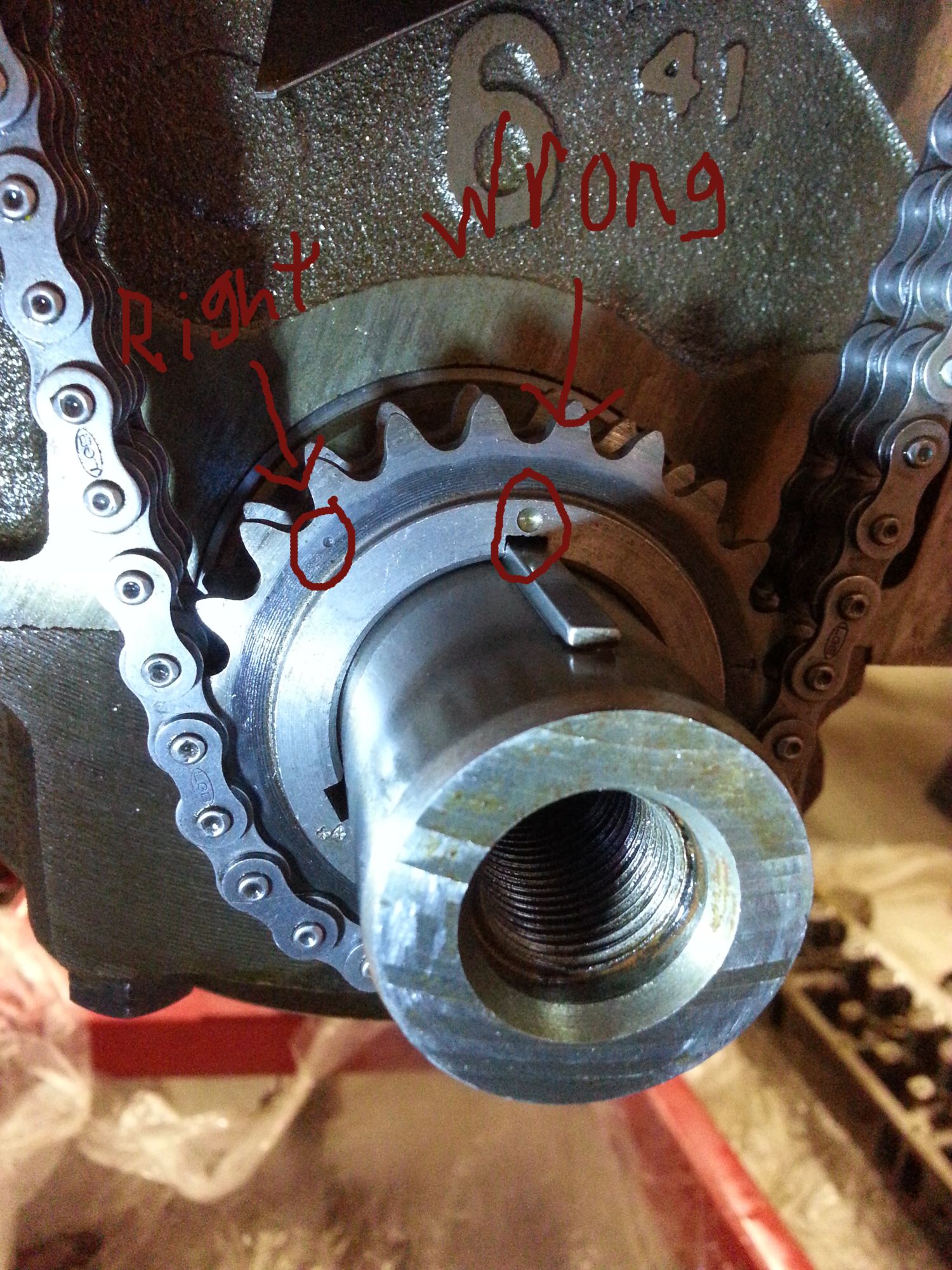

Old Oct 27, 2016 | 04:11 PM
dbbd1's Avatar
dbbd1
Joined: Sep 2015
Posts: 1,552
Like this...
Old Oct 28, 2016 | 12:36 PM
1997JollyGreenGiant's Avatar
1997JollyGreenGiant
Joined: Mar 2013
Posts: 1,130
Likes: 15
From: Somewhere in Kentucky
Originally Posted by dbbd1
Like this...
+1! I learned that one the hard way!
