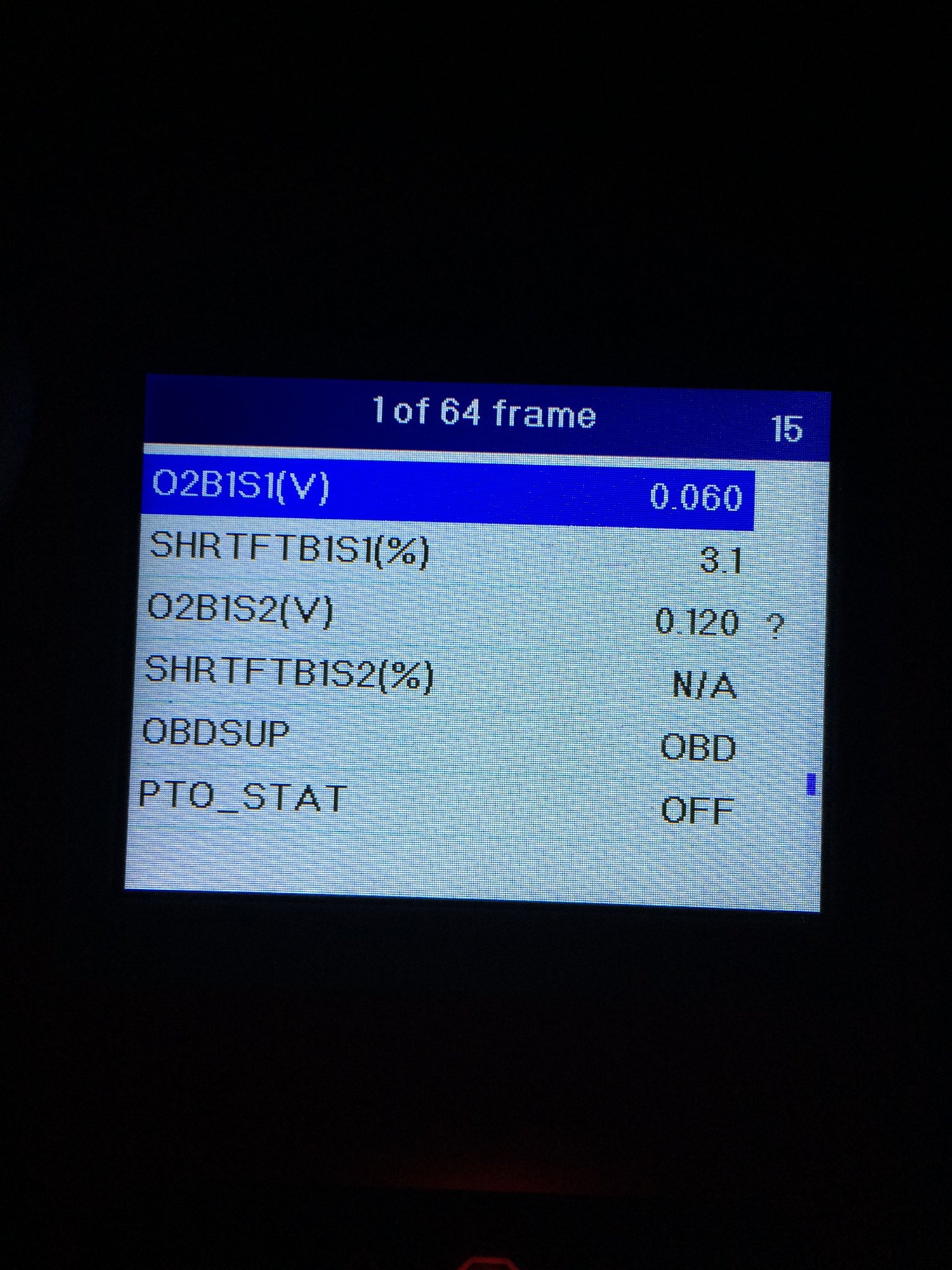

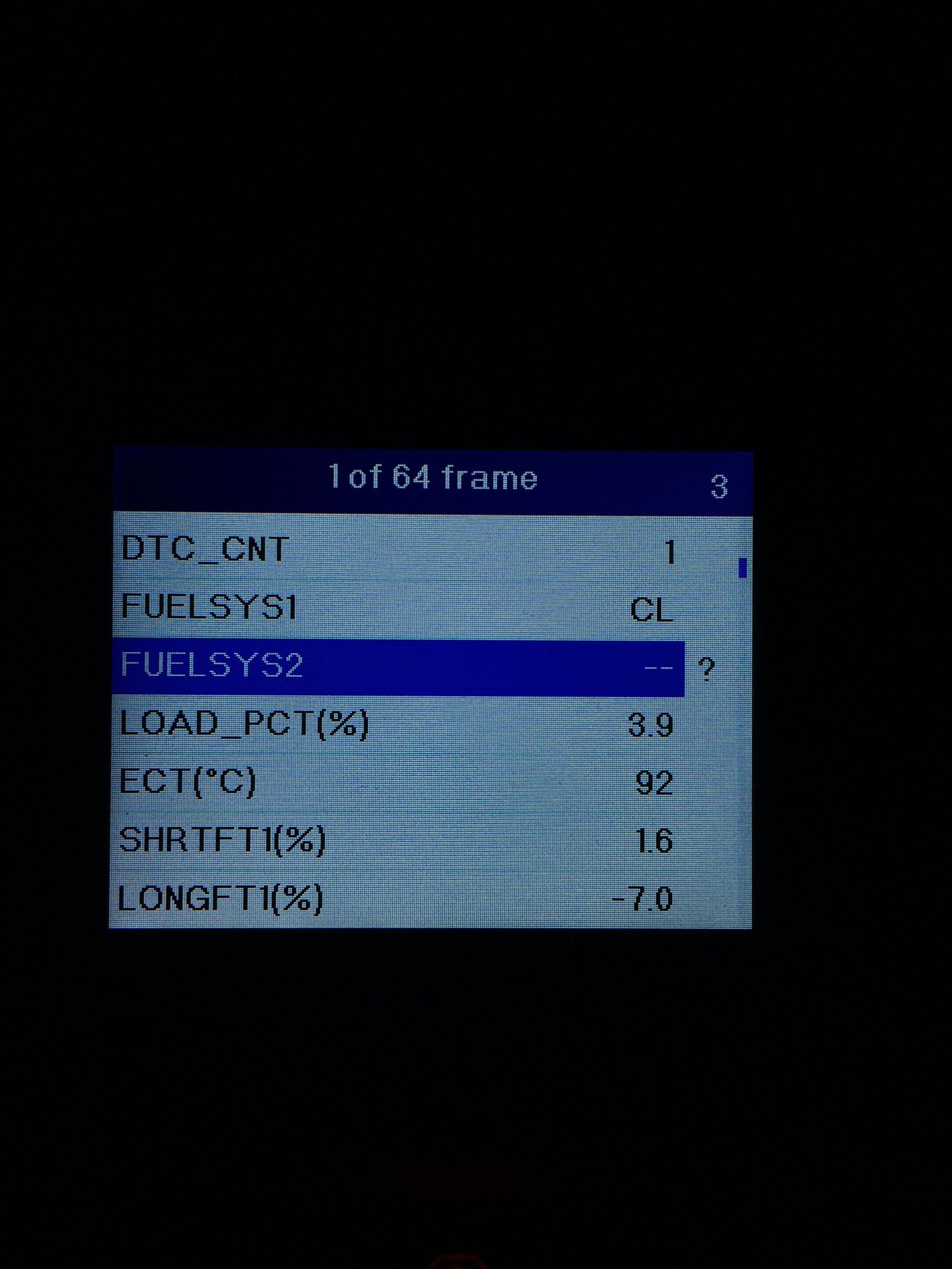

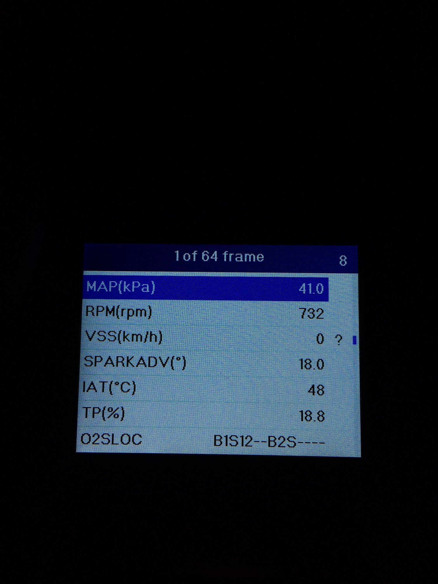

i had to scan my truck to reset a couple codes and did a "live run test" however im having trouble understanding if these values are in the correct range, ext. any help would be appreciated >also showing a inconsistant tp% (15-20ish @ idle) tb is super clean so what would cause this & how can i resolve it? also pretty sure its telling me my o2s are toast but i figured as much

Things look pretty good actually... Of course, Can't see 'live' data in a pic. O2 sensors should bounce around .5 volts, fairly quickly. If they stay constant, they are toast.
Short term fuel trim is adding fuel. (1.6) Long term fuel trim is subtracting fuel. The short term number will likely change fairly regularly as well. LTFT will be a bit more stable.
TPS will likely never hit 0..... but, it should return to the same value at closed throttle. If it doesn't, the throttle either isn't closing all the way, and you need to find out why, or, the sensor simply needs to be replaced.
