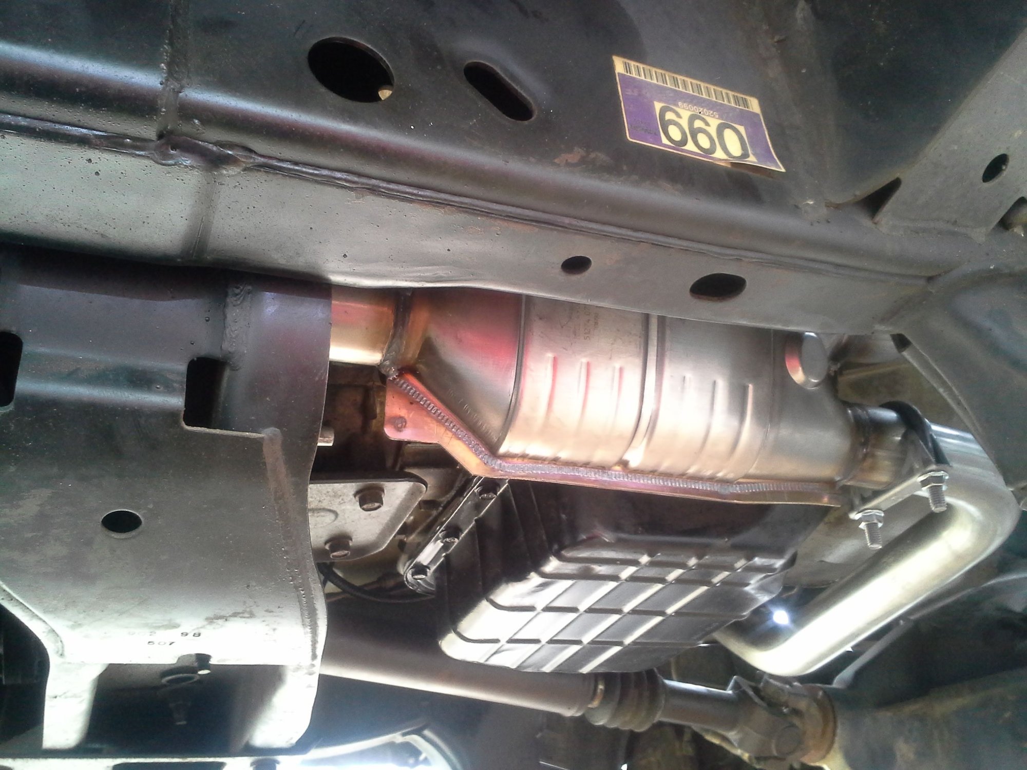

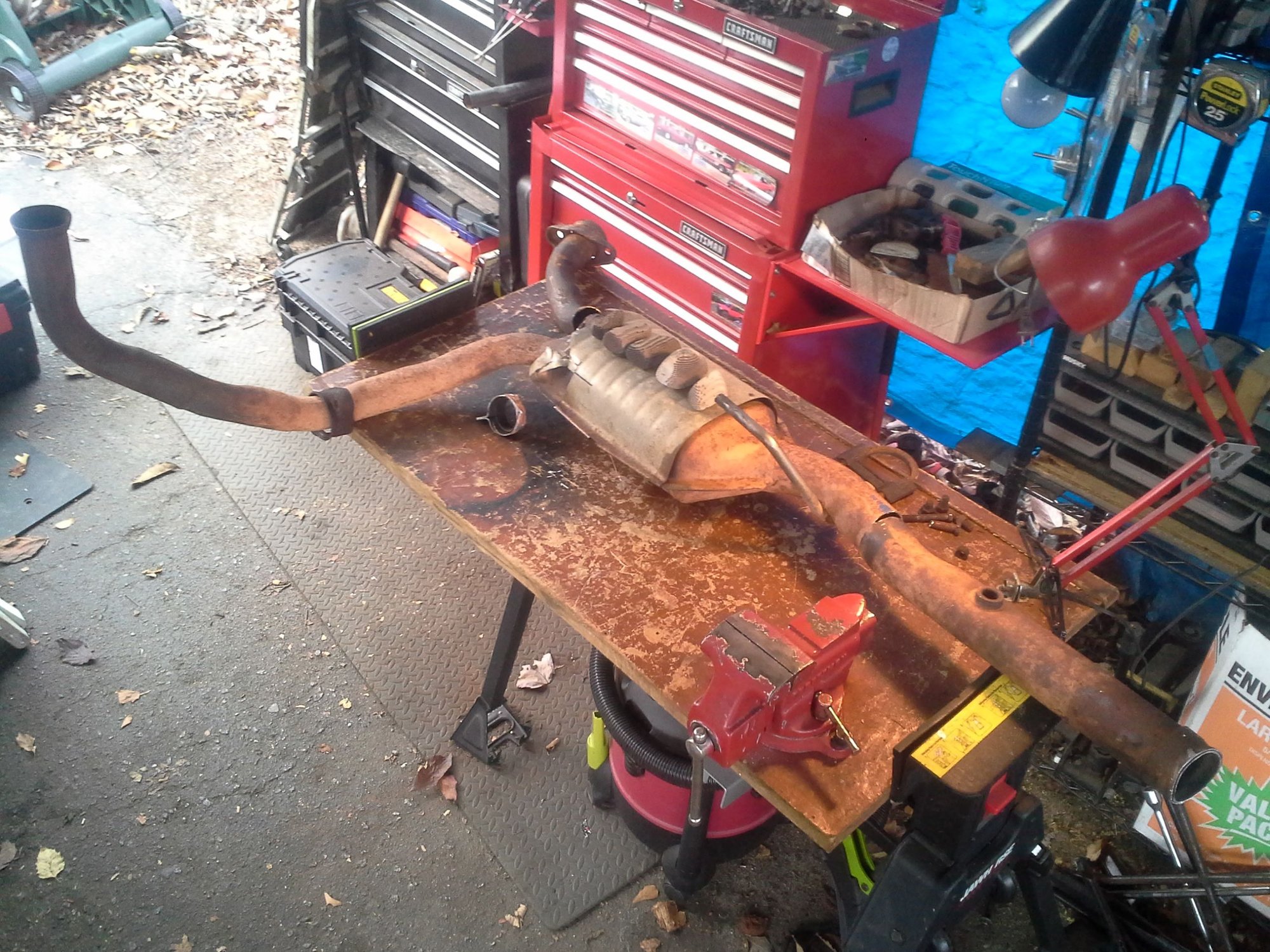

The new magna flow cat kit is on. No more rocks rattling around at start up, Thank Goodness. Had to cut a little bit of the old one out because of a frozen bolt here and there.
But it's quiet now, sounds good enough and was only about 218 bucks(amazon) Thanks for the help too, all the opinions, and the expertise y'all!
Removed from truck. If you can see those volcano looking rock things, those were what was inside the cat.
Heres after the new one was installed:
This is from halfway down the truck, at the muffer, looking towards the engine.
I reused the o2 sensors, no codes yet. (knocking on some wood here!)
Muffler to the left, engine to the right(duh). That trans pan back there always has real lil pinkish/red drippies on it. ??? Needs a servicing maybe?
One more-
It's lot quieter without that banging from those lava rocks in the cat!
Now, can I buy a muffler and put it on without any welding as well?
Thx y'all.

Yep, put the muffler on same way you did the cat. Some clamps and adapters might be required......
I may have to come to SC to find my next truck..... yours looks REALLY clean under there.

That frame is super-clean! Truck must have been kept indoors/garaged when not on the road.
