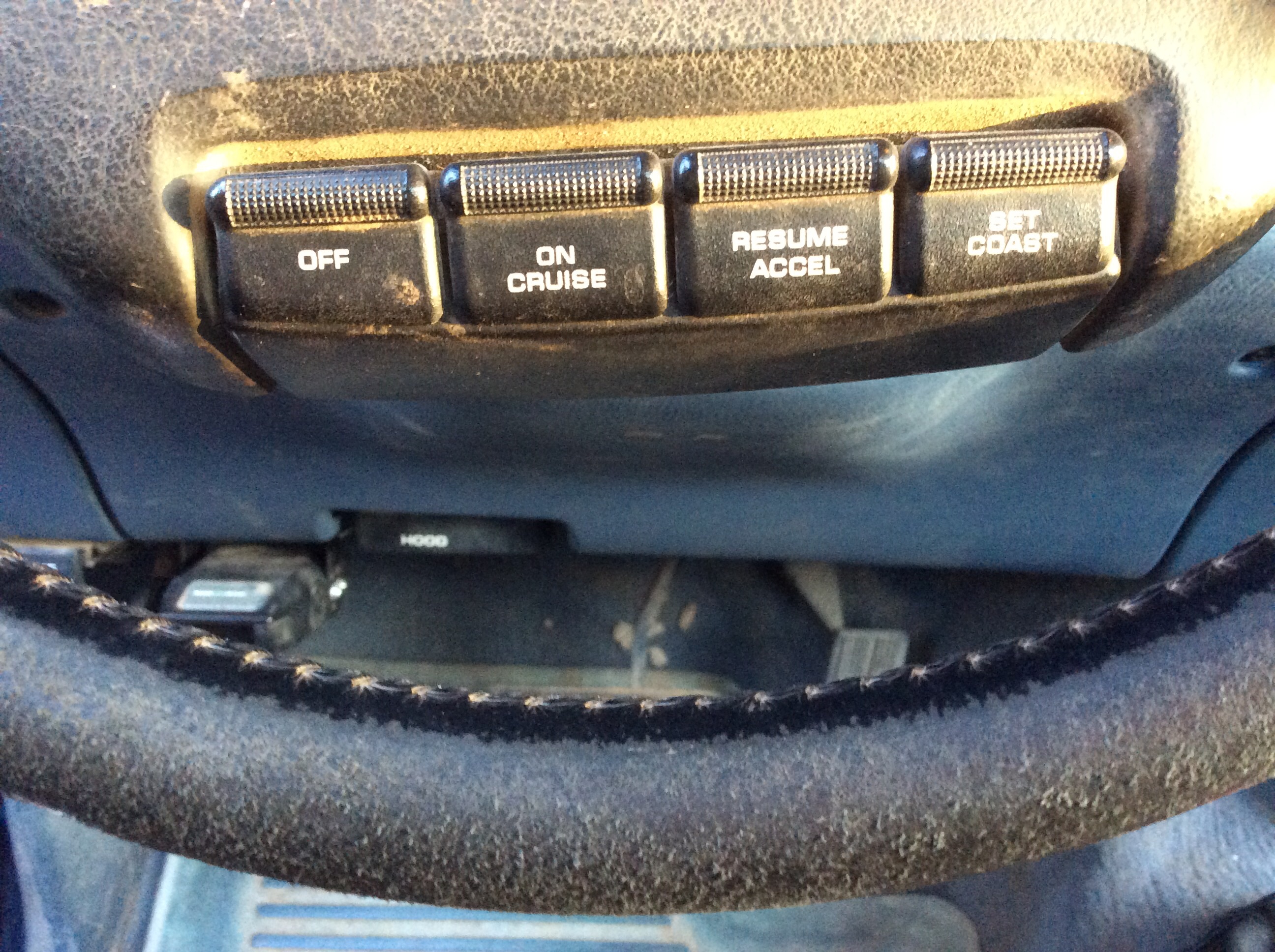

There isn't a cruise light on the dash, its on the steering wheel on yours. Just a little green lite there.
On the switch? If so does it illuminate the cruise on, or just a little led?
If you could, show me a picture cause right now I'm confused lol.

94 Ram, right? Lite should be on the 'button' next to the switch.
Yup 94 Ram.
I can say it's not on the button or switch

Yeah, lite should be on the steering wheel switch set then. Right next to the on/off button. Little green LED. Does that come on?

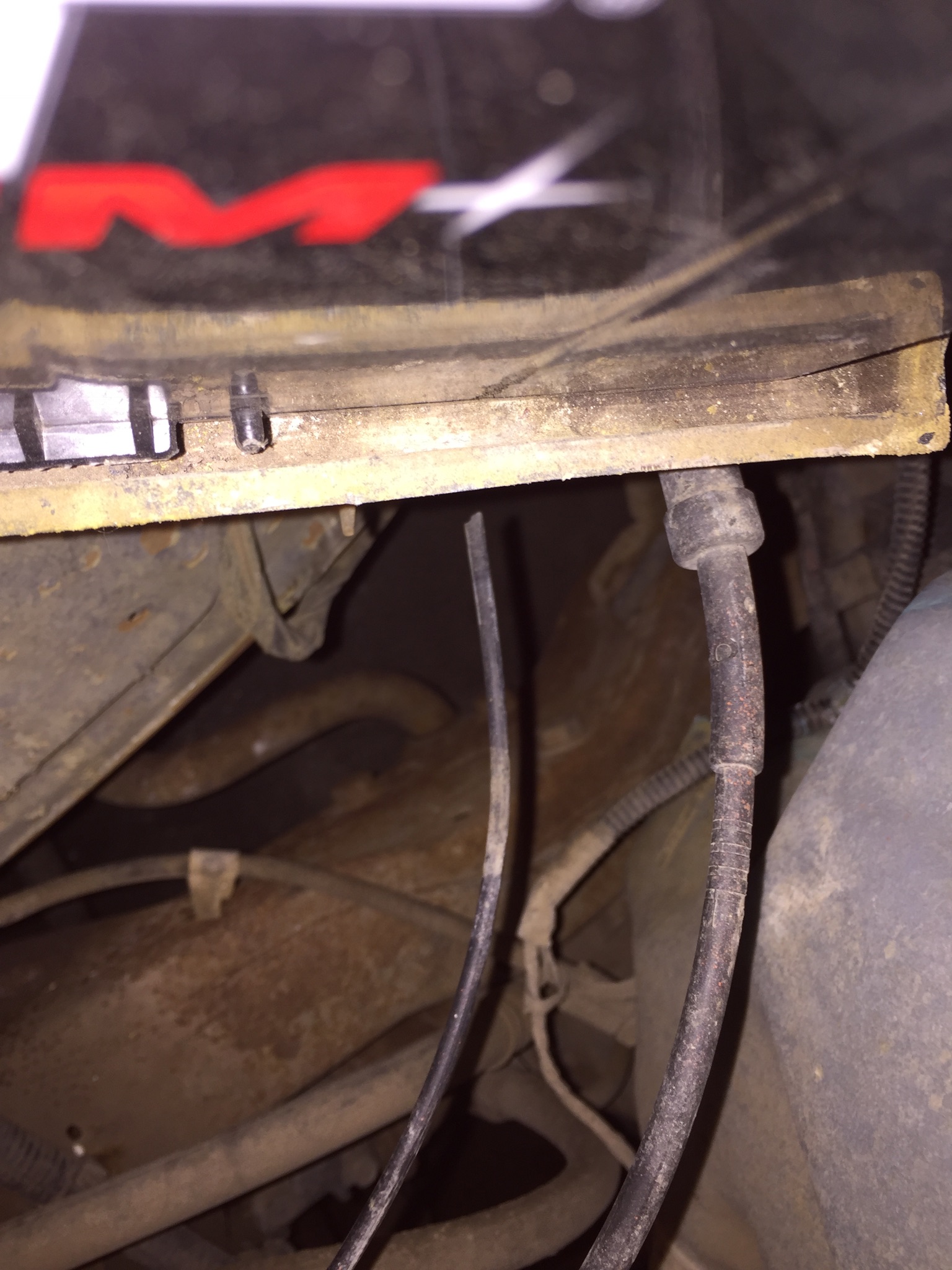

Still see no led, but I took the switch off and knocked a lot of crap out of it, I put it back in and when it hit the on button, I can hear a relay or a click in the engine bay, and again when I turn it off. So I'mpretty sure the switch works. I went to look at the cruise servo, and saw a tiny black hose, so I started the truck and sure enough, it's a vacuum hose leads right to the servo, but I cannot fingure out where it connects there. Here's a pic:
So if that's the hose that rots out I just need to connect it back, and at least that part should work I'm guessing. Still need to check the brake switch.
Originally Posted by Christian Suhr
Yup 94 Ram.
Attachment 27765
Looks like you're right Christian. That is different than any I've seen personally. On all of the 94-97 trucks I've seen the left button is on/off with the next one being blank (your "cruise on" button). In the top middle of that button is a green LED normally.
A quick cruise on Google isn't helping me any either, other than showing me a few switches like yours for sale on eBay. Sorry I'm not more help.
Hey thanks for the input. I got a little confused there, and was wondering why my switch was different than what I saw on google. But it seems to be doing something, so I guess that's not the problem, i need to fix that cruise vacuum line and hopefully it works.

My 94 has separate off switch, and on switch and there are no LED lights.
Dave

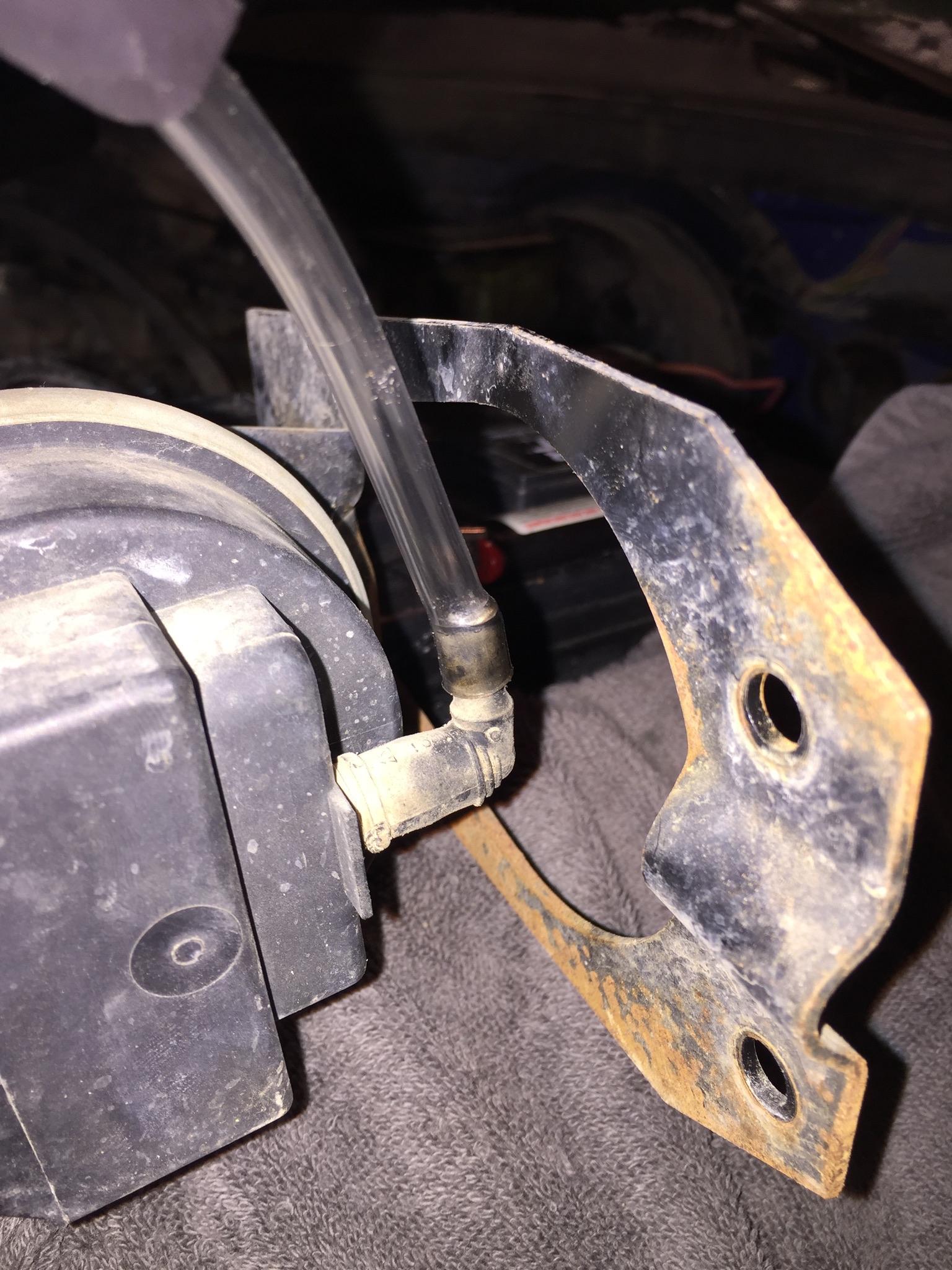

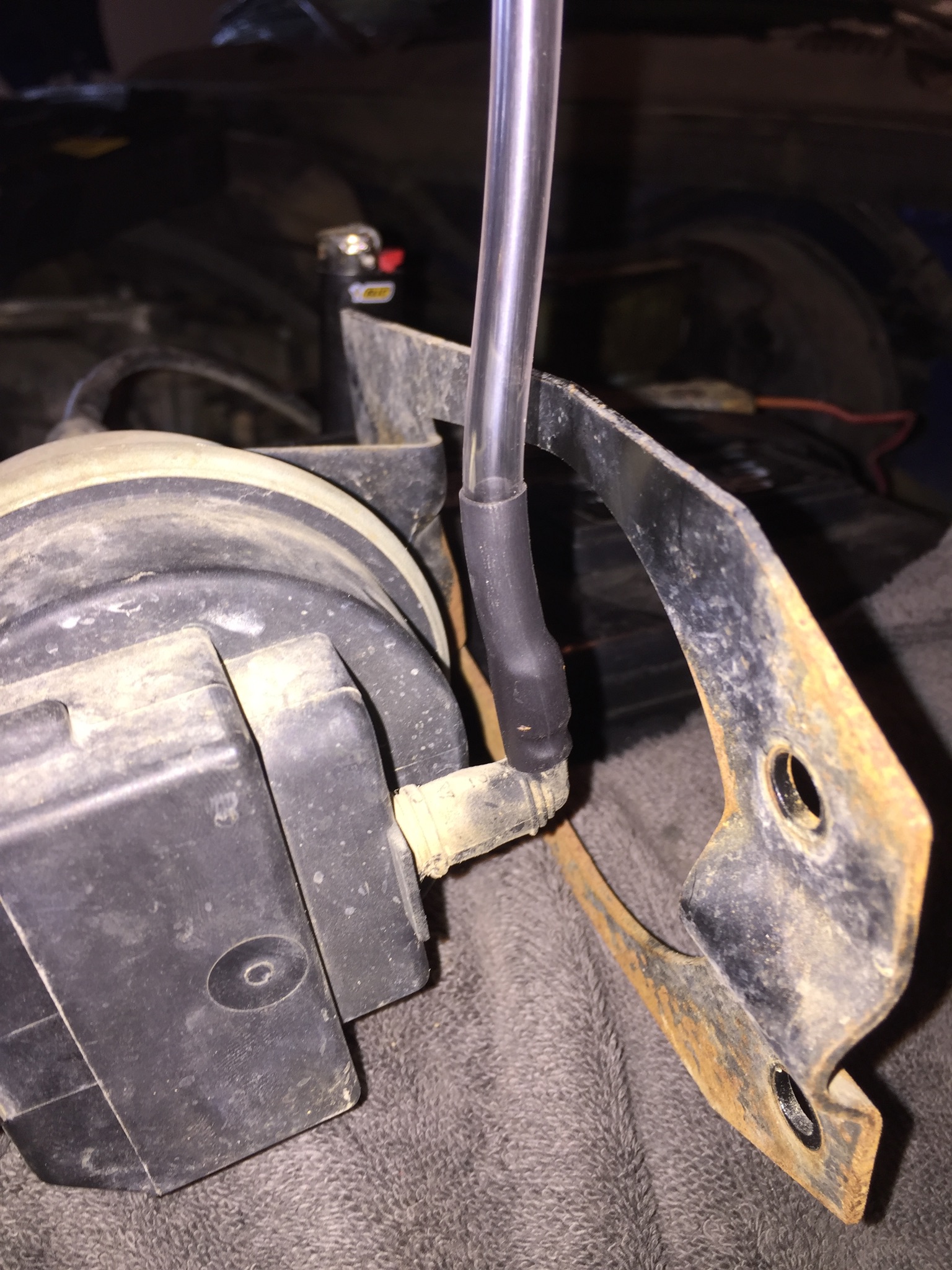

My cruise works now. I had the vacuum hose broke. So I took some vinyl 1/4in hose I had laying around, and heated it up and showed it over the line on the cruise servo, then put some heat schrink over it, next took the line, and put it over what's left of the factor plastic line, and heat shrunk it, ziptied it to hold everything in place and it works! Yea switch or dash has no light, they must've had it in the early years like that.
