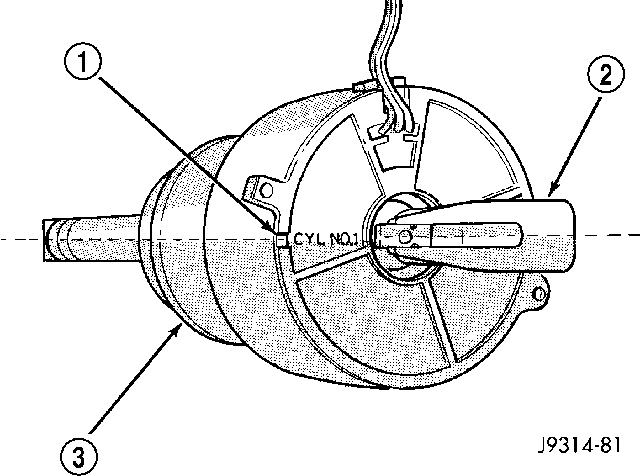

Watch the timing with a timing light on #1 plug wire. I did this before and it should stay the same until you raise the rpm. Did you set the dizzy like this? This will get it in the ball park.

yes i set it that way. Set #1 cyl to TDC, rotated crank until timing mark on balancer lined up on timing cover mark; set oil pump shaft slot pointing to #1 cyl, dropped in distributor per your above picture.
