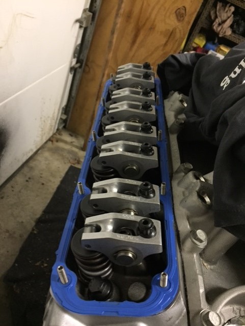

Sorry to be a post ***** lately, as stated in an eariler post my Hughes shaft rocker arms are way off as far as geometry goes. They are contacting the valve stem very close to the valve stem intake end. I called Hughes to inquire about shims and was told by Dave that they should not need shims and that I would be the first person to ever shim these. He told me he sells a ton of them and never herd of anyone shimming the pedetals. He said that it doesnt matter what it looks like at static rest and that I need to do a sweep test with a solid lifter and that my pushrod length could affect this. I understand that this would fall true for a stud mounted rocker arm cause the pushrod dictates the height along with the locking nut. On a shaft mount system there is no adjustment for height on the rocker. The pivot point remains fixed. Pushrods will not raise the rocker. Longer pushrods will only give me more preload. I would need to raise the rocker arm shaft assembly with shims to change the contact point on the valve stem end then once that is centered correctly I can figure out pushrod length and final check with a sweep test. Am I wrong here?? Is Hughes correct??? Any info would really help. Thanks again, Dennis

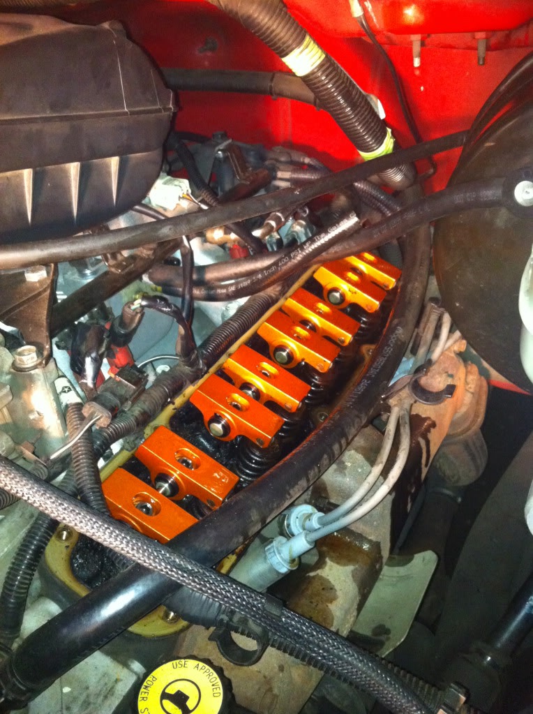

Need more info and pictures. What year and engine? What heads, cam, rockers, pushrods are you using?
You either have pedestal rockers or shaft mount rockers, not both. Please clarify.
If they are roller rockers, most here use stock ratio 1.6 Pedestal, they are paired in sets of 2 with an allignment shaft between the intake and exhaust. No one here using shims for rockers.

Color the valve tips with a marker, install rocker, rotate engine a few times, then check that the rocker contacts the center of the valve stem

Sorry, here are some pics and more info. The motor is a 2001 magnum 5.9. The heads are EQ Iron 1.92 valves with a comp valve job. The rockers are Hughes 1.65 shafts. I didnt assemble the motor, I questioned the machine shop and they told me it would be fine once its running. I dont see how it is going to sweep that far. I am in the process of taking an old lifter and filling it with washers -.80 as per hughes preload and going to do a sweep test. The lifters are not pumped up now so I have to pull a set off to do this (and the manifold). I did some banging around on the internet and have seen some other people with this issue. I called a few mopar builders also and they said when they use Jesel or T&D rockers they shim them if needed. Plus hughes sells shims for rocker arms. I would rather not have to do anything so if anyone can explain to me how these will center I would be really greatful.
Thanks again
Attached Thumbnails Is Hughes correct??-motor.jpg   Is Hughes correct??-motor-3.jpg   Is Hughes correct??-motor-2.jpg

With the valve fully seated, having the roller toward the intake-side edge, isn't unusual. The tip of the rocker will move thru an arc as it opens the valve, moving toward the outside edge of the valve stem. Watch one of your rockers as you roll the motor over slowly, and so long as the roller stays on the valve stem, you should be fine.

I had the same problem, but mine was related to taller valves due to CAM/Springs requirements. I had a local machine shop make some spacers for me. I spoke with some old Mopar guys on the AllPar forums that have used ARP washers to space them out (they used a micrometer to ensure consistent thickness and used a proper geometry set-up procedure)
