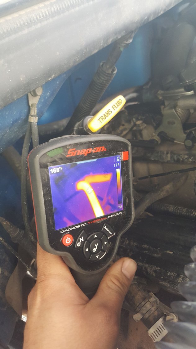

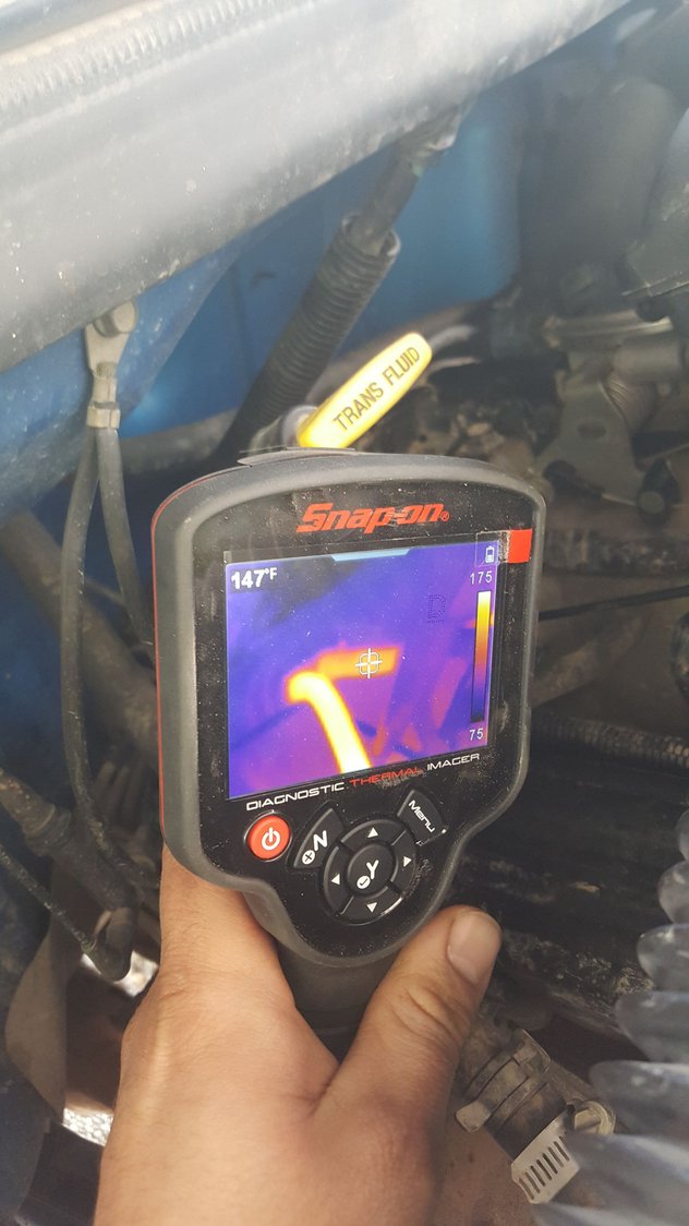

So I burped the system for over an hour and then borrowed a friend's thermal imager to check temperatures.
Any idea how hot these should be? Remember that it is about 32 degrees F during this so there will be a touch of heat loss through the hose. After the letting it run for an hour then driving home 20 miles, it still doesn't get as warm in the cab as it should.

Is the fan not blowing hard, or is the temperature lower than you expect? Just trying to clarify before you tear the whole truck apart.
Edit: Just saw your picture post (cool toy). You can disregard this post

Well, you are getting good heat transfer at least. Trouble is, there is likely still an air pocket in the heater core. If you look at the hose routing, you will see how this can happen. Need to give the air a path to escape the core. According to theory, if you put a flush T in the outlet line, start the engine, crack it open a bit, it *should* allow the air to escape, and make your heater FAR more effective.
