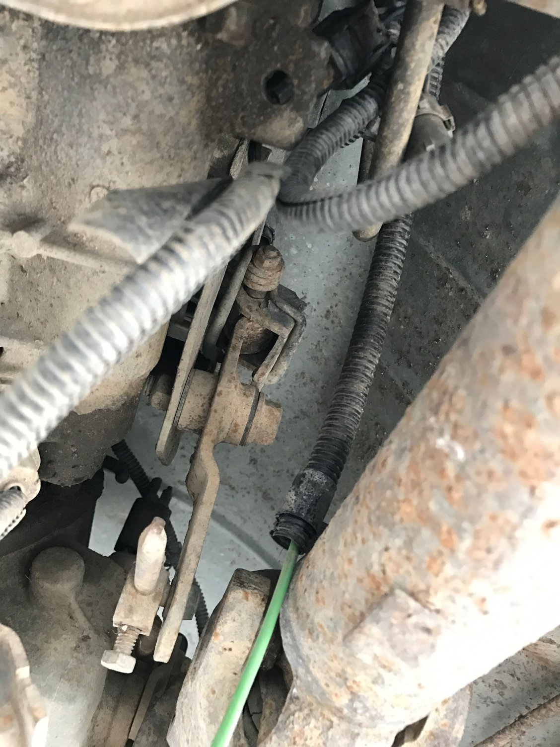

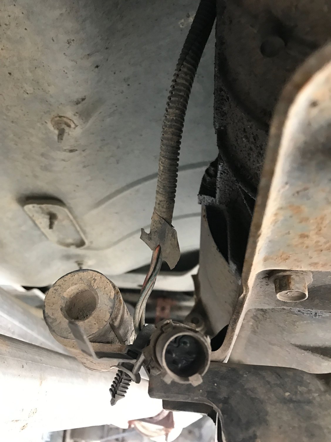

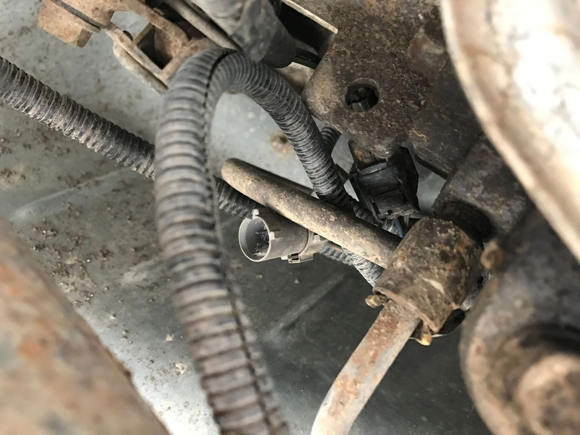

I have a 96 1500 4x4 and found 2 male connectors and a broken wire hanging from the top of my transmission, any idea what they go to? Truck runs, drives, and shifts fine. Just curious

Maybe O2 sensors? Are both of yours in place, and hooked up?
The one on top of the t-case is for the central axle disconnect. It is vacuum powered, and the green line in the one pic should go to a connector that goes on the vacuum switch.
