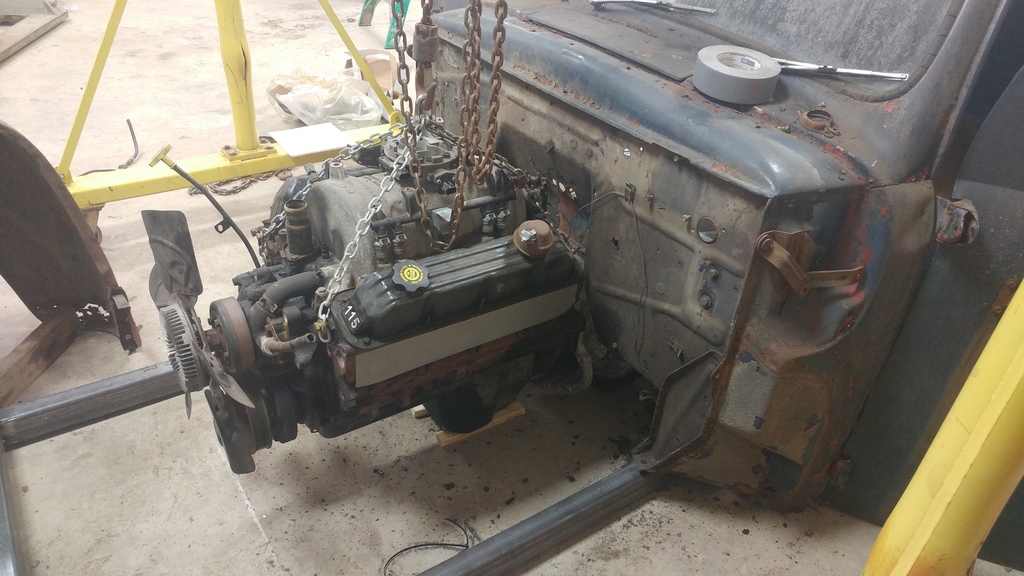

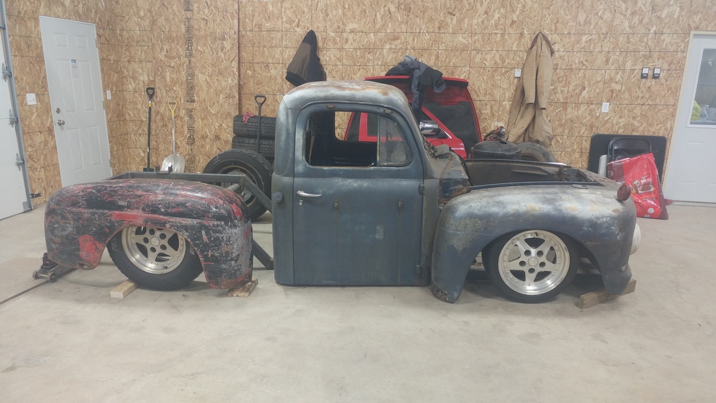

Originally Posted by frankie_b_jr
Now you've peaked our (mine at least) curiosity. Pics when you can please.
Building a 51 f1 rat rod with the driveline from a 97 ram SST. . .

That looks like a nice project. Do you have a build thread anywhere for it? Thanks for sharing.

Not yet, once I get further ill start a thread. I had layed out my plans awhile ago and I got a lot of heat from some members for parting out a SST but the price was right and it fit my needs
