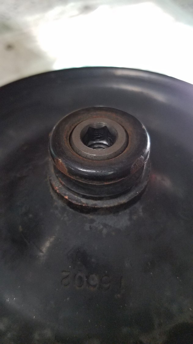

I just ran to Napa and had them warranty swap the pump from 2012. Just got back and trying to get this dang pulley to seat all the way. Wished I had bought a better kit back in the day for pulley r&r. Mines an AmPro, it works okay, but it's definitely fighting me to get the pulley fully seated. I'm about 3/8" from fully seating it. Once I get the new pump in and steering adjusted, I'll report back.

I rented a kit from Oreillys and it worked well enough. At first I though it wasn't seated as far as the original, but since I didn't take a pic, I had no idea. After I put it together, I checked the belt closely to see how it ran and it was fine and true. I don't think it goes on flush (the pulley) but I don't remember.

I just finally said screw it and broke out the impact. She's fully seated now. Perfectly flush.
