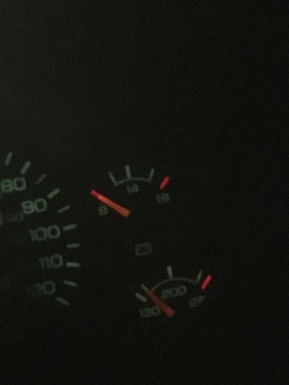

This is where the gauge sits as I pull in my driveway it was higher than that but driving only 7 miles it dropped dramatically. Note the truck is running too

Yup, running straight off of the battery, I presume. Not charging, have you checked any of our recommendations yet?
