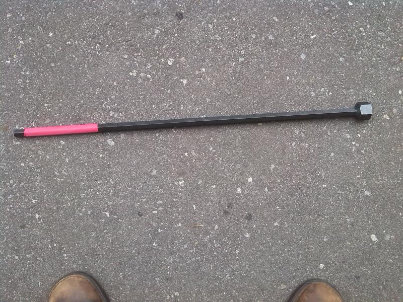

RJ: I would replace both if you are in that far, cups and cones. The manual also gives a rotating torque for new bearings and a different one for used bearings, so throwing both into the mix would probably not be ideal. BTW you will need the threaded adjuster wrench for working on this axle, if you don't already have it.
