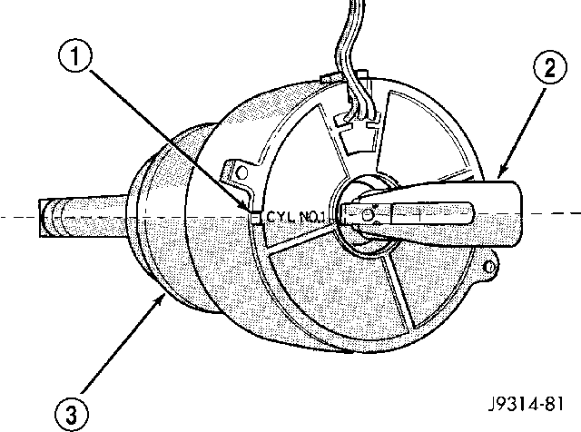

The dizzy position should be like this.
Old Jun 16, 2017 | 06:20 AM
l481273's Avatar
l481273
Joined: Jun 2017
Posts: 5
Yes installed as picture is shown.
