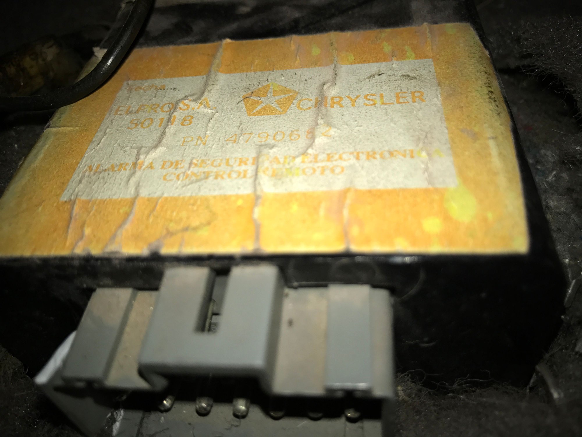

Its a 1996, but i am in mexico, so it was made for the mexican market. that means it has a 3 speed auto transmission and a 5.9 tbi injection engine. it also has the dbr3 port, and the alarm module is under the central seat, it is an EL PRO brand alarm, here is the picture.
part number 4790682<br/>i guess this modules were used in the 80s chrysler models like the viper

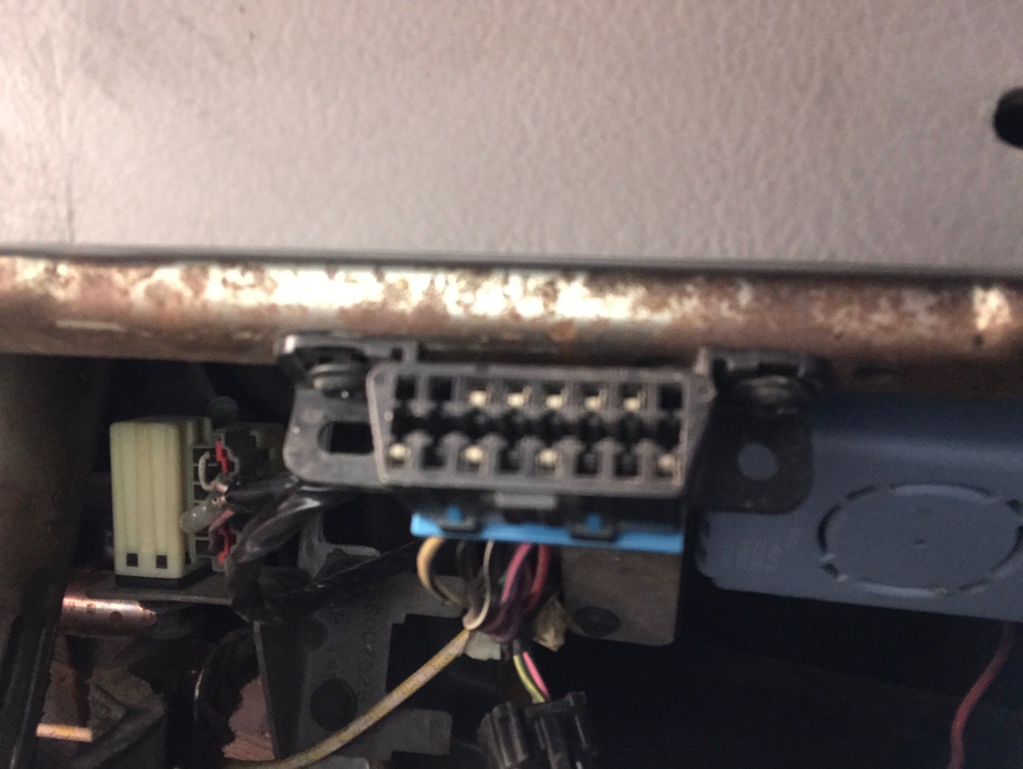

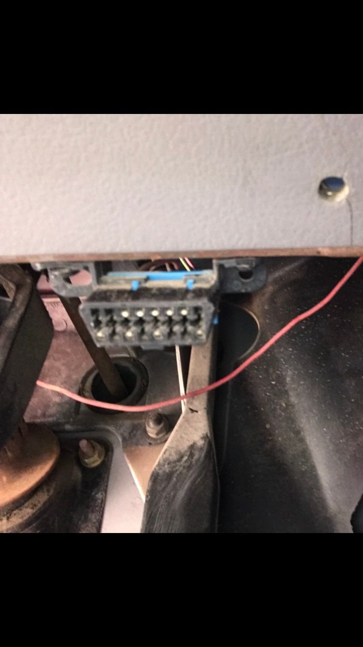

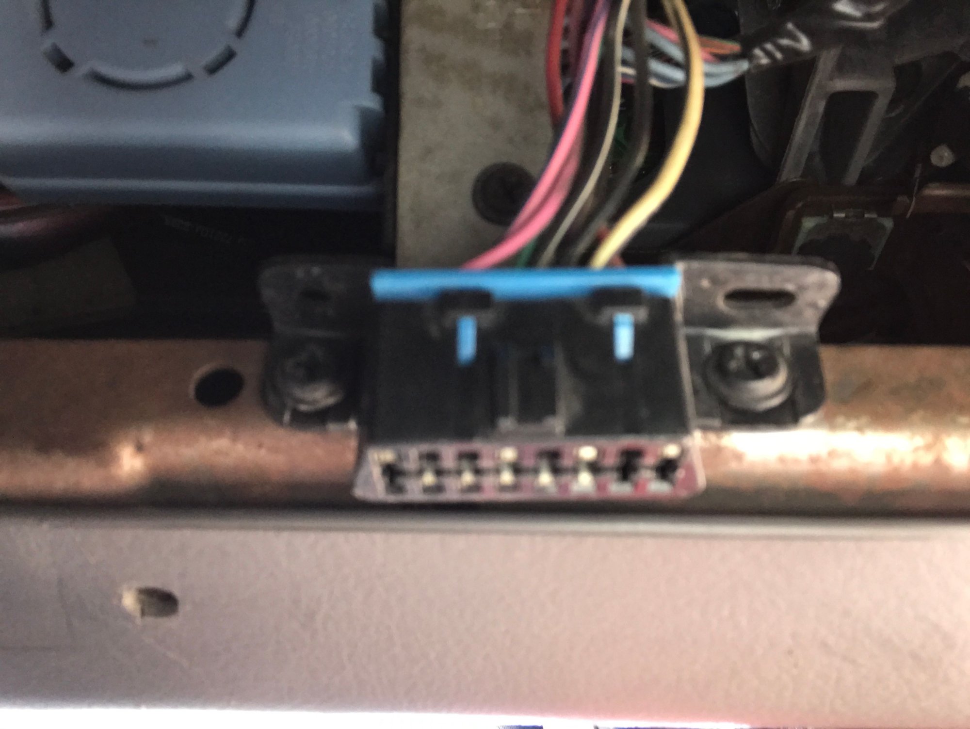

Shape of the OBD connector, can you post a pic of it? Should be under the dash, by the drivers right knee.

Notice some pins aren't there, the dealership told me that not all the models have all the pins

Ok, That's OBDII. Which is a good thing.
You should be able to do the key-dance, (cycle key on-off-on-off-on, quickly) to pull codes. CEL will flash codes. Be ready to count, and have paper/pen ready to write 'em down.
