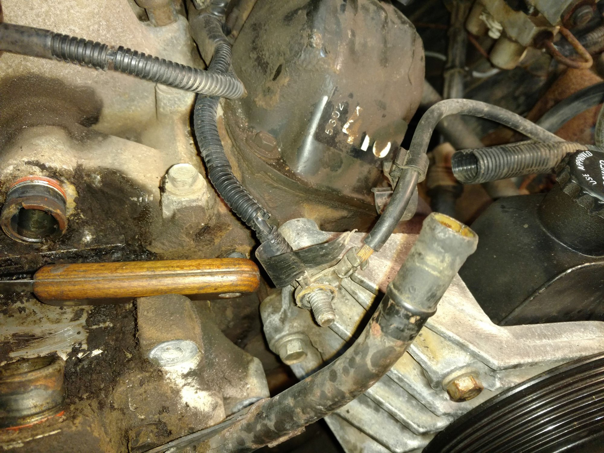

Maybe take your battery cables off and clean them. Both ends, not just on the battery. Take off and clean any ground wires you can find. Hey You will probably remember where they are located. There's one from the battery to the fender, the passenger side of the firewall to the engine, one on the power steering bracket, one on the alternator. This is on my 95, not sure if your's is different.

I think one of these goes to the fuse box on the fender.
Firewall above heater hose.
