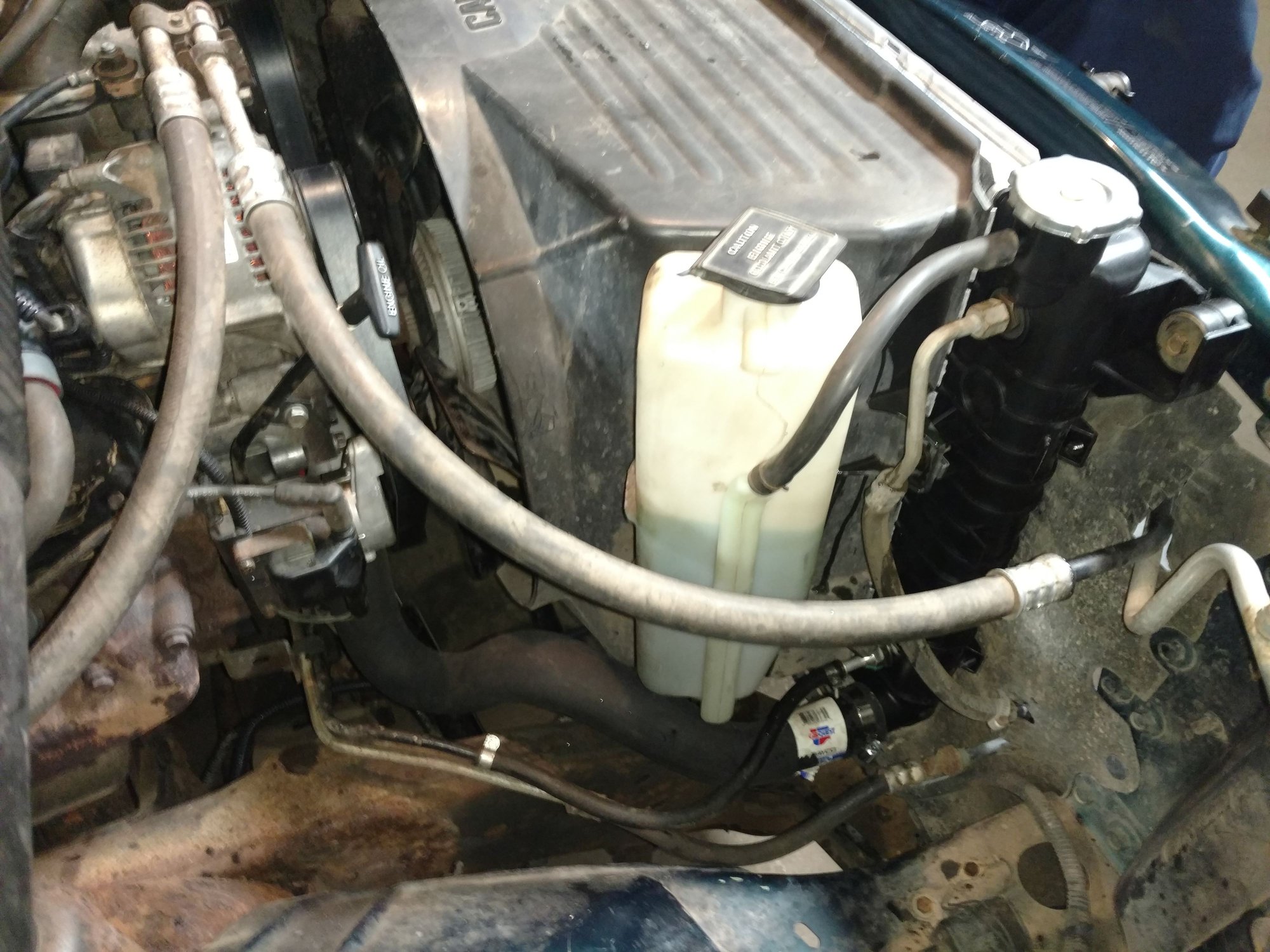

I guess I'd pull the pan and see what it looks like. If it still has the check valve in the cooler line to the radiator, it may have plugged and overheated your transmission. I'll see if I have a picture.

The line with the hose clamps is in place of the factory one with the check valve in it. If the trucks sits a few days I have to put it in neutral so oil flows through the tranny before I put it in gear. Our transmissions don't flow in park unless you have a Sonnax Sure Cure kit installed. ( You need to check fluid level in neutral on a stock tranny because of this.)

mine does have the stock tranny lines, should i do what was done there?
