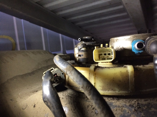

After chasing my tail trying to look for it, I finally got ticked off, bought a fuel pump and went to work. Since the tank was full, I took the bed loose and tilted it up about 10 inches so I could get in there to work. Right after I finished disconnecting everything, I found the problem...
Overjoyed that I didn't have to wrestle the pump any further, I blocked off a short piece of 5/16 fuel line and hooked it right up. So far it seems to have done the job, but with enough gas lost between working on it and disconnecting fuel lines it still smells like gas where I park. I'll be a bit **** about checking the next couple of days before I can relax about having it fixed.
