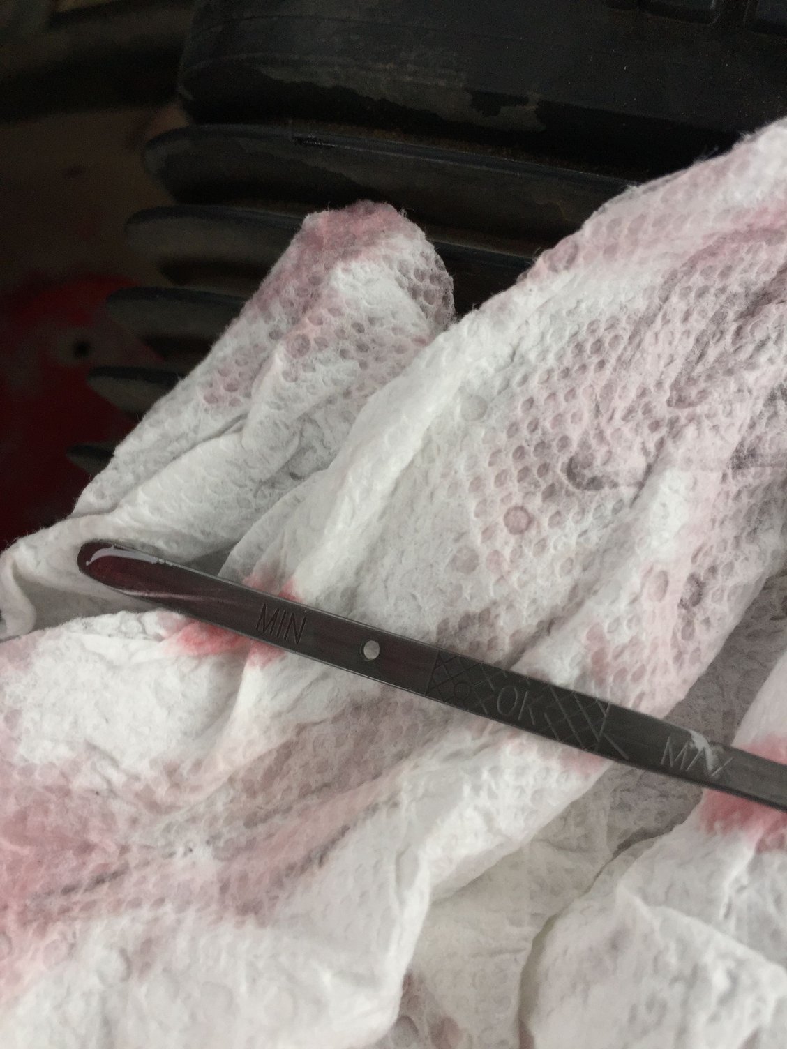

Probably will sound dumb but that pic is of my fluid today after I drove about 20 miles then let it sit for an hour or two then took in on another couple mile drive and letting in idle in neutral for 5-10 minutes. like I said we replaced what we took out and a little extra so I didn't wanna put to much more in but im thinking maybe it was low in the first place quiz I read low fluid can cause p0783 code to come up.

Yeah, that's low. Need to add some more. (start with a pint, only add one pint at a time.)
The wire to the PCM for the O/D solenoid will have power as long as the engine is running. The PCM grounds the circuit to activate the solenoid. Sounds like the wiring is good at least, question becomes, is the solenoid bad, or is the PCM bad......
