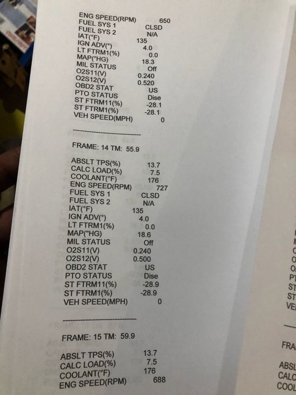

Default Freeze frame data
So I am currently running with my o2 plugged in me an a buddy we’re trying to log some data kinda just messing around seeing what came up on his hand held scanner tool. An the truck seems to run great I do suspect it to be the idle air control unit.
I believe the beginning of my o2 sensor issue was simply the truck didn’t like the first ones I put in. It seems to only have an issue when I need it to idle in Park or neutral an if it does start idiling weird I pop it into drive an it seems to do fine. An it will die if I let it but it throws no code while doing so.
So I was able to print off the data from the truck while it was having this idiling issue. Is anyone on the forum able to look at the data an see if they can maybe confirm or see any other issues. I simply have no idea how to understand what I’m looking at.
The photos uploaded in the wrong order but the rough idle started around frame 11 to 15

I note that map drops off significantly, even though engine load, and RPM don't change that much....... Check the little rubber elbow that feeds the map vacuum. See if it is clogged, or just dried out, and leaking.
