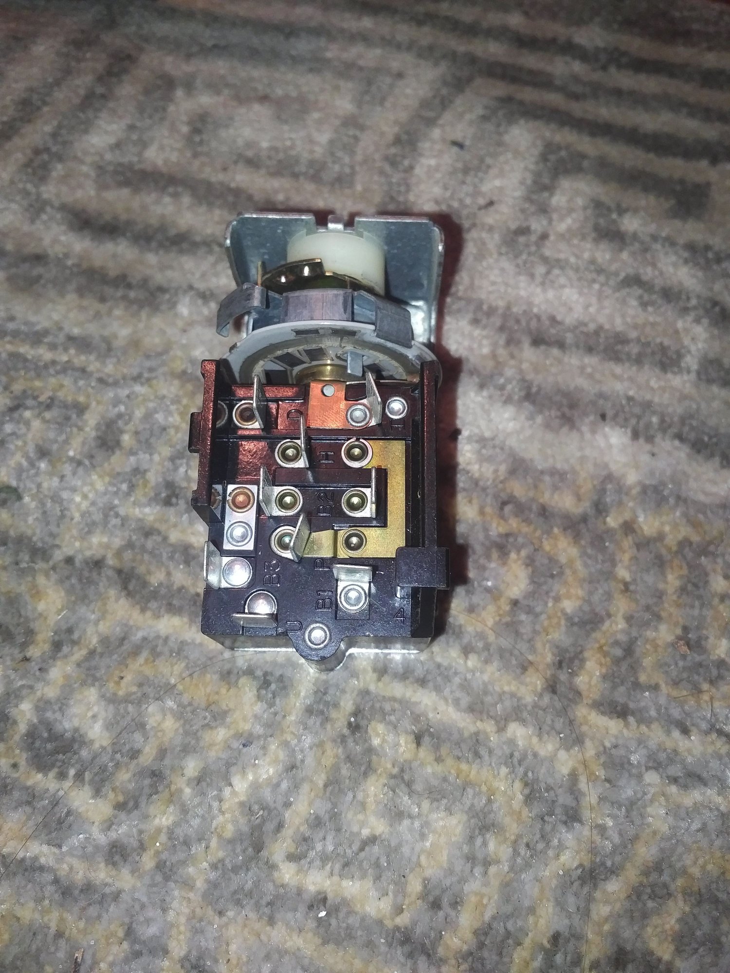

I didn't get around to as much as I would have hoped in the cold, dark weather, but tonight I got the headlight switch out. It's the original Chrysler unit with no visible burns or marks and prior to removal the switch was solid. I'm a little skeptical, but I ordered a super cheap knockoff replacement just to see if it's a switch problem anyway. That arrives tomorrow, along with an OBD2 scanner to troubleshoot a surprise CEL. Can these things be damaged internally and not show burns or melts?

If the connector looks good as well, you are likely going to have to look elsewhere for the problem..... put in the new switch when it shows up anyway, and see what happens. Take it from there.

Miraculously, it was the switch. There must have been something burnt or worn internally, because the crappy new one worked right away. Add this to your catalog of mysteries - the HL switch can fail internally without any signs of burns.

Update - Switch is still working, and gets super hot under normal operation. Really scary design, ordering the LMC Truck harness kit tomorrow.
