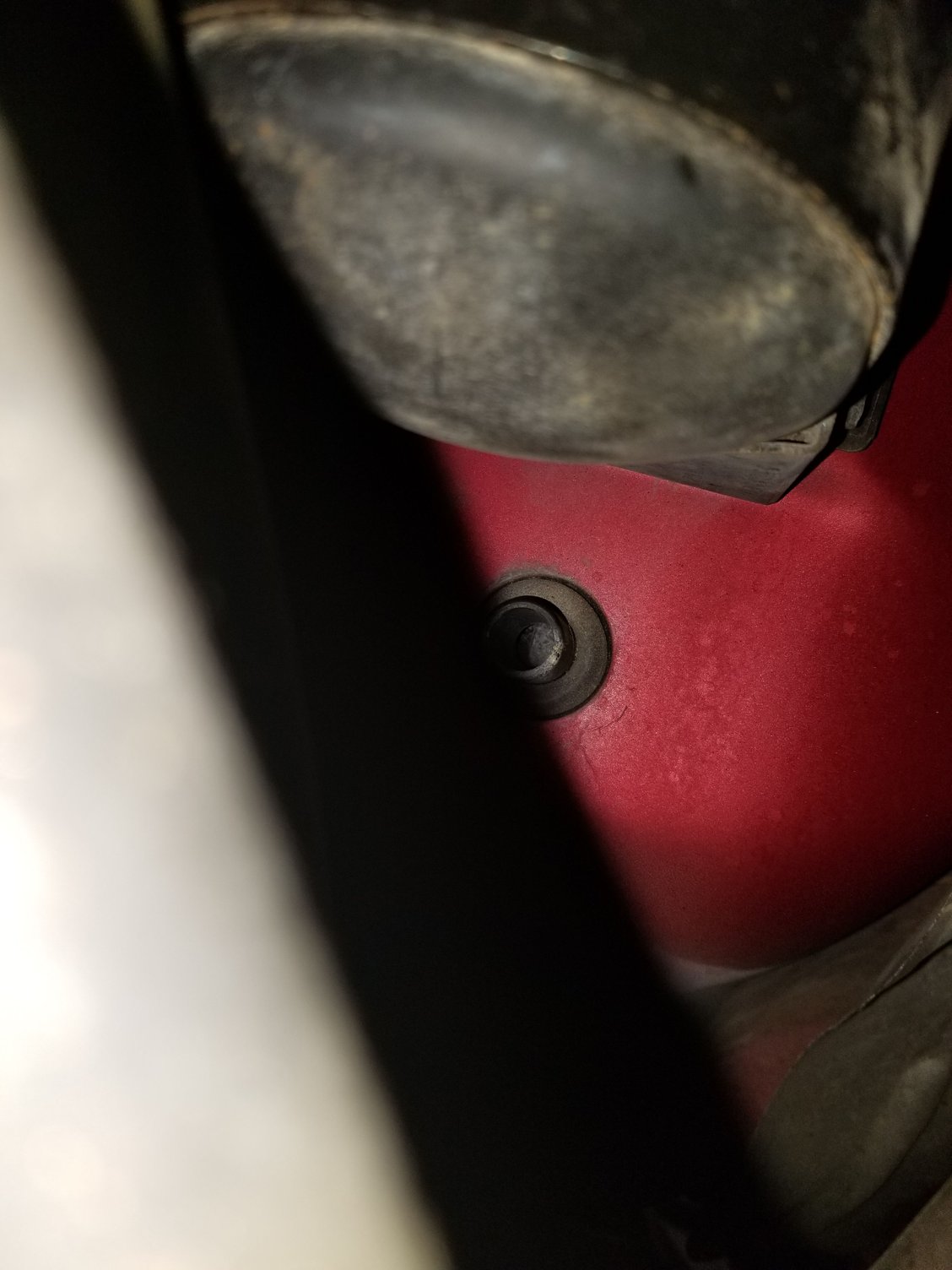

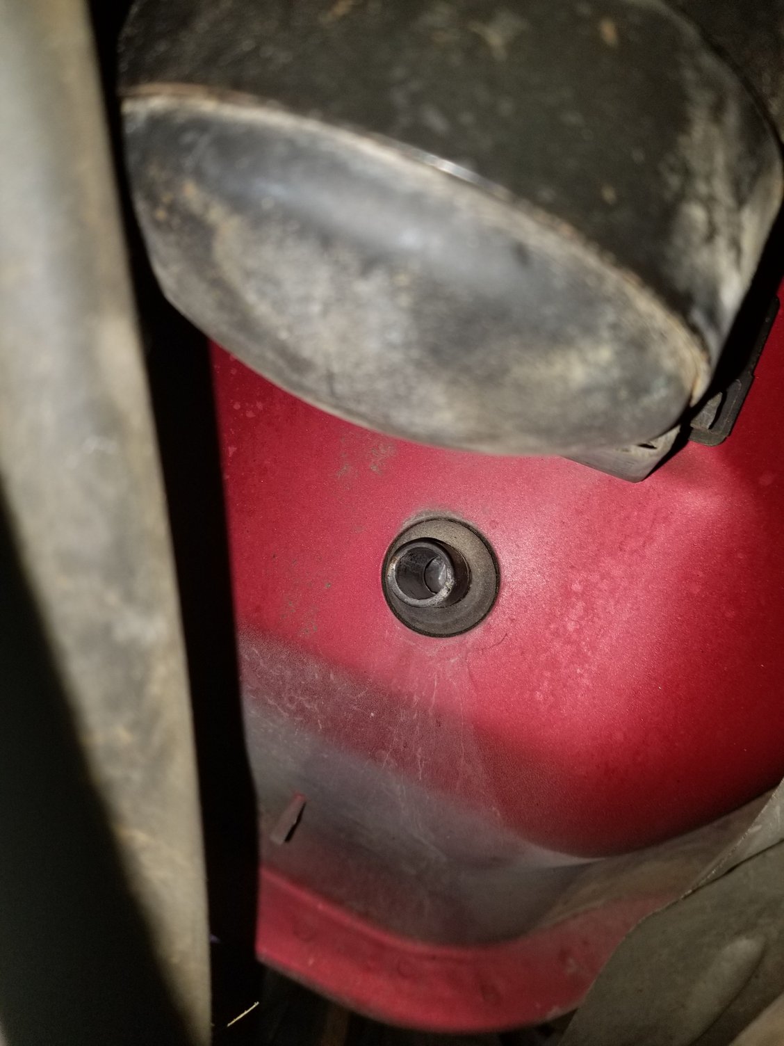

Well after some searching here and googling it seems likely that as condensation is leaking in(it's been a hell of a week, I have run both ac, and heater...but not much of either)
common wisdom says the ac drain is either blocked or poorly designed.
I found it under the accumulator. I can stick 2" of wire in it. Nothing came out and it won' go further than that.
going to try a 90 degree elbow and silicon on the outside. If anyone has dealt with this, any other suggestions?
the drain on the outside under accumulator...right?

That's typically it... the condensate tracks back along the bottom of the drain and through the firewall.
Get a Dorman PCV elbow and push it over the drain (something like this)

Well, fingers crossed that was it. I used a heater hose with 90 degree elbow cut down to size...
Old Nov 19, 2017 | 03:38 PM

That'll work...

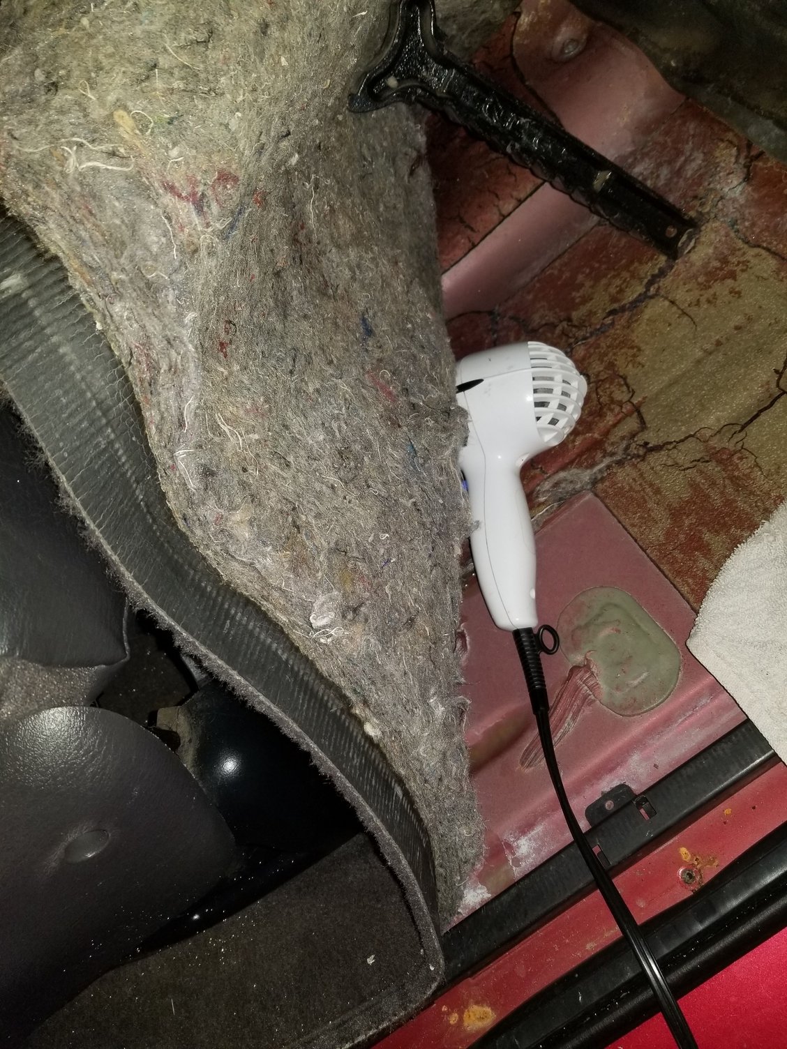

As to water removal... borrowing the wife and daughters backup hair drier...because clearly I wouldn't own one.

Why wouldn't you need a hair dryer? I mean, seriously, floors get wet.......
I generally try and suck up as much as I can with a shop vac.
