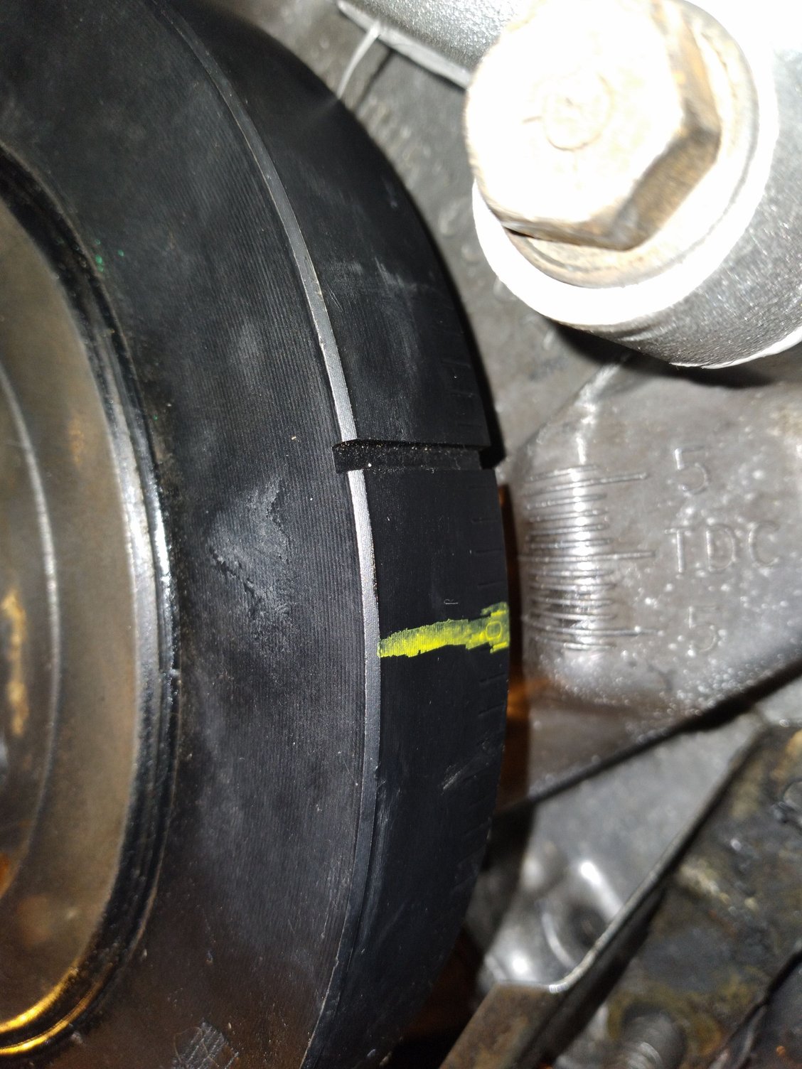

Recently dropped a 5.2 in my '95 and I had a question about how to set fuel sync. I know there are plenty of forums on how to do it but I'd like to know how to do it in my case. So I rebuilt my motor and used a harmonic balancer from advance auto. I know when you set fuel sync on the engine you're supposed to have a "V8" marking on the balancer, but mine doesn't have one. Is there any way to go about doing it without bringing it to a shop?

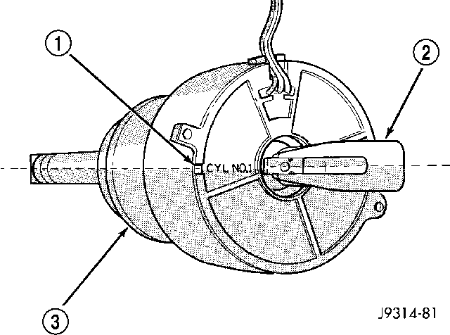

OK quick and dirty method Direct copy of what he posted
put the damper on TDC be sure the rotor is pointing
at the #1 wire for both methods. Now remove the dist
cap you will see a line on the plastic pickup plate and
it says cyl. climb up and look straight down over the
rotor and center the button on the rotor over the cyl
line. and tighten down. I had an accuracy of + - 2 doing
it this way.
Here is a pic...

Originally Posted by Moparite
Here is a pic...
THIS! Nice Thank You
BTW the tighten down reference is to the nut that holds the Distributor in place. You'd be rotating the dist a tiny bit to get the alignment not the rotor ****.

About to lose my mind over this truck. 98 dodge 5.2 1500. Got the wrong bulb for dome light got dad to run to the store exhange for right one was gave a 60 amp glass fuse me not paying attention put it in and it blew than started running poorly. Been working on it for a couple months. had it going at first but was running very rich started with fuel pump, all sensors, harness re loomed, taped, ect plug replaced, traced grounds and fixed (one under battery previous owners had the battery blow-up was completely corroded cleaned and new terminal), 2nd break down plenum, timing chain and sprockets, 140 alt fuse, was going hei distrubitor but won't clear keg took off replaced with basic, msd ign coil, 8.2 plugs, water pump, oil pump and screen, harmonic balancer bought from O'Reilly different than original do I put on the middle 10? And is that the way it goes? It's at first compression stroke. Dont Have timing light. Was reading way fuel sync can be done with out tuner or scannerd. Needing helpful leads if anyone has anything it would be greatly appreciated.
