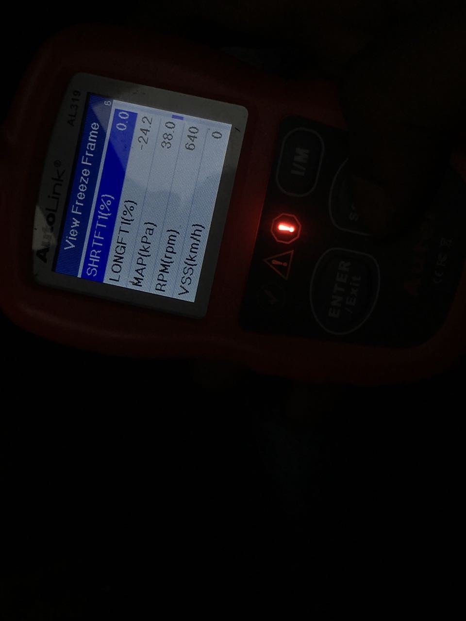

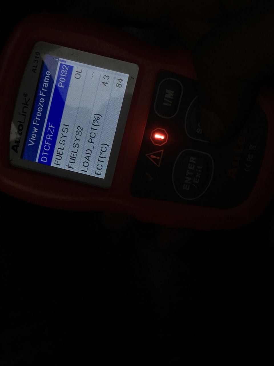

And I just changed the coolant today. And when then truck reached operating temp. I smelled burnt smell, and the truck was trying to turn off when I reved. And I did changed the catalytic converter, o2 sensor. And I just ordered a new Throttle Position sensor. Still getting p0132 and p0138. High heater circuit voltage in b1s1 and b1s2. Please can u give me advise in this. Still haven’t got my plates since I couldn’t pass my emissions.
